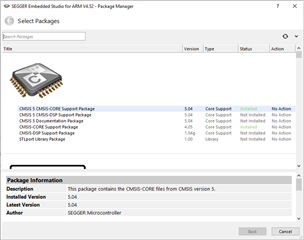

I get a warning every time I launch SES of cmsis header files that exist and dated later...
After I select Yes to All, or No to All, it tells me to get I license, which I just click continue, and then after that everything works fine.

  • I ran into this exact issue when setting up a new workstation with SES (Nordic Edition) V4.52. I noticed that back in SES (Nordic Edition) V4.18, the CMSIS-CORE 4.05 package was used nRF CPU Support Package, but in the newer versions, it is using CMSIS 5 CMSIS-CORE 5.04.
    It turns out that if you just also install the old CMSIS-CORE 4.05 package alongside the CMSIS 5 CMSIS-CORE 5.04 package, the problem goes away. Problem solved!
