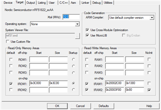

  • Tried with NRF51822QFAA 16KB 256KB specification:
    I used the above settings and tried to build but I got an error like,
    Error: L6406E: No space in execution regions with.ANY selector matching arm_startup_nrf51.o(STACK).
    Error: L6407E: Sections of aggregate size 0x800 bytes could not fit into.ANY selector(s).

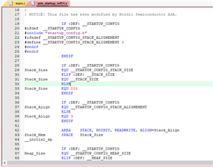

    and I searched in the forum and found one solution for this,
    in that forum, they suggested reducing the stack size from 2048 to 255 in amr_startup_nrf51.s file.
    Now the build was done successfully. I can flash into the target device. started advertising and connected with nRconnect chosen DFU option loaded zip file into the app. then the app started to upload the file to the target device. but failed.
    please guide me if had done any mistake.
     Was this the application or the bootloader project?
