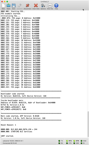

Hard fault in the fds_init() method using the nrf52832 with RTOS + Softdevice when trying to store an string in a record using fds after loading app with boot loader
Hello everyone,
I'm working in an application where I need to store a string in flash so I can keep that value like if it where settings when doing a firmware update so the app can read those values and use them to configure some stuff inside my app. But I noticed an issue when trying to initialize the fds_init when updating the app using a boot loader, the app can run fds_init if I don't use the boot loader.

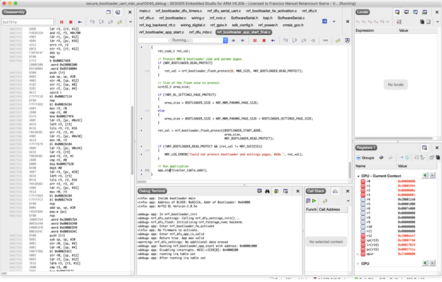

Do you know if the boot loader can affect the FDS file system In a way that can cause a crash or affecting some interrupts that the wait_for_fds_ready is stuck waiting after fds_init causing a hard fault crashing the app.
I'm having an odd issue using the ads library, if I load the app the first time with the programmer the app works just fine, but if I use the boot loader it will crash the call to fds_init.

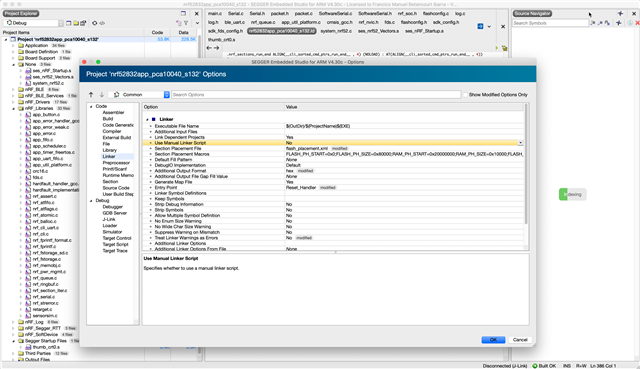

<!DOCTYPE Linker_Placement_File>
<Root name="Flash Section Placement">
  <MemorySegment name="FLASH" start="$(FLASH_PH_START)" size="$(FLASH_PH_SIZE)">
    <ProgramSection load="no" name=".reserved_flash" start="$(FLASH_PH_START)" size="$(FLASH_START)-$(FLASH_PH_START)" />
    <ProgramSection alignment="0x100" load="Yes" name=".vectors" start="$(FLASH_START)" />
    <ProgramSection alignment="4" load="Yes" name=".init" />
    <ProgramSection alignment="4" load="Yes" name=".init_rodata" />
    <ProgramSection alignment="4" load="Yes" name=".text" />
    <ProgramSection alignment="4" keep="Yes" load="Yes" name=".sdh_soc_observers" inputsections="*(SORT(.sdh_soc_observers*))" address_symbol="__start_sdh_soc_observers" end_symbol="__stop_sdh_soc_observers" />
    <ProgramSection alignment="4" keep="Yes" load="Yes" name=".sdh_ble_observers" inputsections="*(SORT(.sdh_ble_observers*))" address_symbol="__start_sdh_ble_observers" end_symbol="__stop_sdh_ble_observers" />
    <ProgramSection alignment="4" keep="Yes" load="Yes" name=".log_const_data" inputsections="*(SORT(.log_const_data*))" address_symbol="__start_log_const_data" end_symbol="__stop_log_const_data" />
    <ProgramSection alignment="4" keep="Yes" load="Yes" name=".nrf_balloc" inputsections="*(.nrf_balloc*)" address_symbol="__start_nrf_balloc" end_symbol="__stop_nrf_balloc" />
    <ProgramSection alignment="4" keep="Yes" load="Yes" name=".sdh_state_observers" inputsections="*(SORT(.sdh_state_observers*))" address_symbol="__start_sdh_state_observers" end_symbol="__stop_sdh_state_observers" />
    <ProgramSection alignment="4" keep="Yes" load="Yes" name=".sdh_stack_observers" inputsections="*(SORT(.sdh_stack_observers*))" address_symbol="__start_sdh_stack_observers" end_symbol="__stop_sdh_stack_observers" />
    <ProgramSection alignment="4" keep="Yes" load="Yes" name=".sdh_req_observers" inputsections="*(SORT(.sdh_req_observers*))" address_symbol="__start_sdh_req_observers" end_symbol="__stop_sdh_req_observers" />
    <ProgramSection alignment="4" keep="Yes" load="Yes" name=".nrf_queue" inputsections="*(.nrf_queue*)" address_symbol="__start_nrf_queue" end_symbol="__stop_nrf_queue" />
    <ProgramSection alignment="4" keep="Yes" load="Yes" name=".cli_command" inputsections="*(.cli_command*)" address_symbol="__start_cli_command" end_symbol="__stop_cli_command" />
    <ProgramSection alignment="4" keep="Yes" load="Yes" name=".crypto_data" inputsections="*(SORT(.crypto_data*))" address_symbol="__start_crypto_data" end_symbol="__stop_crypto_data" />
    <ProgramSection alignment="4" keep="Yes" load="Yes" name=".pwr_mgmt_data" inputsections="*(SORT(.pwr_mgmt_data*))" address_symbol="__start_pwr_mgmt_data" end_symbol="__stop_pwr_mgmt_data" />
    <ProgramSection alignment="4" keep="Yes" load="No" name=".nrf_sections" address_symbol="__start_nrf_sections" />
    <ProgramSection alignment="4" keep="Yes" load="Yes" name=".log_dynamic_data"  inputsections="*(SORT(.log_dynamic_data*))" runin=".log_dynamic_data_run"/>
    <ProgramSection alignment="4" keep="Yes" load="Yes" name=".fs_data"  inputsections="*(.fs_data*)" runin=".fs_data_run"/>
    <ProgramSection alignment="4" keep="Yes" load="Yes" name=".cli_sorted_cmd_ptrs"  inputsections="*(.cli_sorted_cmd_ptrs*)" runin=".cli_sorted_cmd_ptrs_run"/>
    <ProgramSection alignment="4" load="Yes" name=".dtors" />
    <ProgramSection alignment="4" load="Yes" name=".ctors" />
    <ProgramSection alignment="4" load="Yes" name=".rodata" />
    <ProgramSection alignment="4" load="Yes" name=".ARM.exidx" address_symbol="__exidx_start" end_symbol="__exidx_end" />
    <ProgramSection alignment="4" load="Yes" runin=".fast_run" name=".fast" />
    <ProgramSection alignment="4" load="Yes" runin=".data_run" name=".data" />
    <ProgramSection alignment="4" load="Yes" runin=".tdata_run" name=".tdata" />
  </MemorySegment>
  <MemorySegment name="RAM" start="$(RAM_PH_START)" size="$(RAM_PH_SIZE)">
    <ProgramSection load="no" name=".reserved_ram" start="$(RAM_PH_START)" size="$(RAM_START)-$(RAM_PH_START)" />
    <ProgramSection alignment="0x100" load="No" name=".vectors_ram" start="$(RAM_START)" address_symbol="__app_ram_start__"/>
    <ProgramSection alignment="4" keep="Yes" load="No" name=".nrf_sections_run" address_symbol="__start_nrf_sections_run" />
    <ProgramSection alignment="4" keep="Yes" load="No" name=".log_dynamic_data_run" address_symbol="__start_log_dynamic_data" end_symbol="__stop_log_dynamic_data" />
    <ProgramSection alignment="4" keep="Yes" load="No" name=".fs_data_run" address_symbol="__start_fs_data" end_symbol="__stop_fs_data" />
    <ProgramSection alignment="4" keep="Yes" load="No" name=".cli_sorted_cmd_ptrs_run" address_symbol="__start_cli_sorted_cmd_ptrs" end_symbol="__stop_cli_sorted_cmd_ptrs" />
    <ProgramSection alignment="4" keep="Yes" load="No" name=".nrf_sections_run_end" address_symbol="__end_nrf_sections_run" />
    <ProgramSection alignment="4" load="No" name=".fast_run" />
    <ProgramSection alignment="4" load="No" name=".data_run" />
    <ProgramSection alignment="4" load="No" name=".tdata_run" />
    <ProgramSection alignment="4" load="No" name=".bss" />
    <ProgramSection alignment="4" load="No" name=".tbss" />
    <ProgramSection alignment="4" load="No" name=".non_init" />
    <ProgramSection alignment="4" size="__HEAPSIZE__" load="No" name=".heap" />
    <ProgramSection alignment="8" size="__STACKSIZE__" load="No" place_from_segment_end="Yes" name=".stack"  address_symbol="__StackLimit" end_symbol="__StackTop"/>
    <ProgramSection alignment="8" size="__STACKSIZE_PROCESS__" load="No" name=".stack_process" />
  </MemorySegment>
</Root>

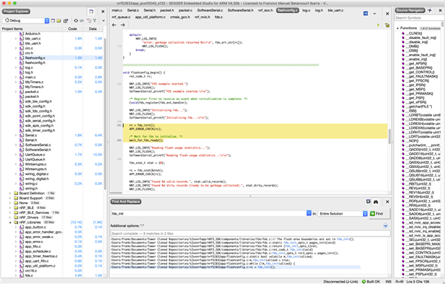

It is crashing something after the fds_init and before wait_for_fds_ready.
The data I am trying to store is just a simple string I based the code on the fstorage app.

void flashconfig_begin() {
    ret_code_t rc;
    NRF_LOG_INFO("FDS example started.")
    NRF_LOG_FLUSH();
    SoftwareSerial_printf("FDS example started.\r\n");
    /* Register first to receive an event when initialization is complete. */
    (void)fds_register(fds_evt_handler);
    NRF_LOG_INFO("Initializing fds...");
    NRF_LOG_FLUSH();
    SoftwareSerial_printf("Initializing fds...\r\n");
    rc = fds_init();
    APP_ERROR_CHECK(rc);
    /* Wait for fds to initialize. */
    wait_for_fds_ready();

I think  the issue is related to something like you must initialize ble_init before using FDS or so, it's what I was researching as the ble_init is also doing some initialization for the sofdevice too and that is causing the wait_for_fds_ready to never exit.
main() => peer_manager_init() => pm_init() => pds_init() => fds_init()
The issue of the fds_init is happening when using the bootloader, the original boot loader from nordic.
So I don't know if there is an issue with some corrupted records or an interrupt ire table that is not correctly assigned when we use the boot loader and run the app.
if I use the debugger from the boot loader side it will crash in app_start.
If I use the debugger in the app it will crash in the flash init after the boot loader starts the app, I used a serial console to output the log and verify this.
Is there an alternative way to store an string in flash that will be available during boot loader app updates? like the flash write example?
