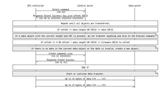

I'm adding buttonless DFU support to my nRF52810 application using the instructions here. I'm using SDK 15.3.0, SD 112 6.1.1.
First question: These instructions state that use of Peer Manager is a prerequisite. If my application does not use bonding, is Peer Manager still a prerequisite?
I was successful in adding buttonless DFU support to the ble_app_blinky example application. Generally, I followed these steps:
1. Generated private/public key pair.
2. Replaced dfu_public_key.c for the example secure bootloader project at: <nRF5 SDK Folder>/examples/dfu/
3. Built application <nRF5 SDK Folder>/examples/dfu/secure_bootloader/pca10040e_ble/ses/secure_bootloader_ble_s112_pca10040e.emProject
4. Updated the ble_app_blinky example app according to Nordic instructions (added dfu .c files to project, added preprocessor definitions, added include directories, made changes to sdk_config.h, added includes and source additions to main.c).
5. Built ble_app_blinky with added buttonless DFU support.
6. Generated the bootloader settings file using nrfutil for the application ble_app_blinky_pca10040e_s112.hex
7. Using mergehex, merged the bootloader settings, bootloader and softdevice together.
8. Merged the output of 7 with the application.
9. Used nrfjprog to erase, program and reset the nRF52 dev kit.
10. Using nRF Connect (mobile for iOS v2.1.1) I verified that the secure DFU service is available.
11. Then I created a version 2 of the ble_app_blinky application (I just changed which LED is turned on when connected via BLE).
12. Created a DFU package for the new application (--application-version 2 --hw-version 52 --sd-req 0xB8).
13. I transferred the package from 12 to my iOS device, then used nRF Connect (mobile) to connect to the nRF52 dev kit and perform a DFU using the package from 12. All worked well.
Then ... I proceeded to follow the same steps to add buttonless DFU support to my own BLE application. My BLE application is the ble_app_uart example app with uart stripped out and TWIM added. The hex file for the built application is 158K.
After programming the dev kit with the bootloader settings + bootloader + v1 of application, I created version 2 of the application, created the DFU package, transferred to my iOS device and tried to DFU to the dev kit. I get timeout error for Data object 2/14. I've attached the nRF Connect mobile log. I tried the same using nRF Connect desktop (macOS, Bluetooth Low Energy v2.3.2). I've attached log for that as well.
This is new learning for me. Appreciate any guidance.

00:16:30.942	Application data folder: /Users/timsenger/Library/Application Support/nrfconnect/pc-nrfconnect-ble
00:16:36.099	Validating connectivity firmware for device with serial number 000682909244...
00:16:44.487	Connectivity firmware is valid.
00:16:44.488	Note: Adapters with Segger JLink debug probe requires MSD to be disabled to function properly on MacOS and Linux. Please visit www.nordicsemi.com/nRFConnectOSXfix for further instructions.
00:16:44.488	Getting information from J-Link debugger...
00:16:45.011	Found device type: unknown. J-Link firmware: J-Link OB-SAM3U128-V2-NordicSemi compiled Jan 7 2019 14:07:15.
00:16:45.011	Connectivity firmware version: 4.1.1. SoftDevice API version: 3. Baud rate: 1000000.
00:16:45.012	Opening adapter connected to /dev/tty.usbmodem1421
00:16:45.939	Successfully opened /dev/tty.usbmodem1421. Baud rate: 1000000. Flow control: none. Parity: none.
00:16:45.940	Reset performed on adapter /dev/tty.usbmodem1421
00:16:47.011	Adapter connected to /dev/tty.usbmodem1421 opened
00:16:52.685	Scan started
00:16:55.268	Connecting to device
00:16:55.492	Connected to device F8:19:52:5B:2D:9E
00:16:55.509	ATT MTU changed, new value is 247
00:16:55.715	Attribute value read, handle: 0x03, value (0x): 62-65-61-6D-20-38
00:17:35.160	Disconnected from device F8:19:52:5B:2D:9E, reason: undefined
00:17:35.162	Performing DFU with file: /Users/timsenger/Documents/my_buttonless_dfu/my_app_v2.zip
00:17:35.549	Attribute value changed, handle: 0x17, value (0x): 02-00
00:17:35.564	Attribute value changed, handle: 0x16, value (0x): 01
00:17:35.567	Attribute value changed, handle: 0x16, value (0x): 20-01-01
00:17:40.584	Attribute value changed, handle: 0x10, value (0x): 01-00
00:17:40.614	Attribute value changed, handle: 0x0F, value (0x): 02-00-00
00:17:40.615	Attribute value changed, handle: 0x0F, value (0x): 60-02-01
00:17:40.673	Attribute value changed, handle: 0x0F, value (0x): 06-01
00:17:40.703	Attribute value changed, handle: 0x0F, value (0x): 60-06-01-00-02-00-00-8D-00-00-00-1D-CE-52-43
00:17:40.734	Attribute value changed, handle: 0x0F, value (0x): 04
00:17:40.734	Attribute value changed, handle: 0x0F, value (0x): 60-04-01
00:17:40.764	Attribute value changed, handle: 0x0F, value (0x): 06-02
00:17:40.766	Attribute value changed, handle: 0x0F, value (0x): 60-06-01-00-10-00-00-00-00-00-00-00-00-00-00
00:17:40.794	Attribute value changed, handle: 0x0F, value (0x): 06-02
00:17:40.794	Attribute value changed, handle: 0x0F, value (0x): 60-06-01-00-10-00-00-00-00-00-00-00-00-00-00
00:17:40.824	Attribute value changed, handle: 0x0F, value (0x): 01-02-00-10-00-00
00:17:40.825	Attribute value changed, handle: 0x0F, value (0x): 60-01-01
00:17:42.360	Received status with code 4 Unknown value, message: 'Error sending packet to target. Code: 0x802a'
00:17:42.384	Attribute value changed, handle: 0x0F, value (0x): 01-02-00-10-00-00
00:17:42.385	Attribute value changed, handle: 0x0F, value (0x): 60-01-01
00:17:43.901	Received status with code 4 Unknown value, message: 'Error sending packet to target. Code: 0x802a'
00:17:43.929	Attribute value changed, handle: 0x0F, value (0x): 01-02-00-10-00-00
00:17:43.931	Attribute value changed, handle: 0x0F, value (0x): 60-01-01
00:17:46.884	DFU failed with error: When writing data to DFU Packet Characteristic on DFU Target: Failed to write to attribute with handle: 13: Error occured when writing. Errorcode: Unknown value (0x8005) .
00:17:46.888	Received status with code 4 Unknown value, message: 'Error sending packet to target. Code: 0x802a'
     I assume that the code size of the application is smaller than 158K, otherwise the image would have been rejected as this is to large for the flash left when one subtracts the SD( 100kB) and the bootloader(24kB). Anyways, from the log I see that the init packet is received correctly and that the fist part of the firmware image transfer is initiated, but you're getting an error when the actual data transfer starts
    , i.e. after the END IF in the attached sequence diagram.
    Is possible for you to use the pca10056e_ble_debug bootloader and capture te log from the DFUtarget as well? Or will there then not be enough space for your application?
