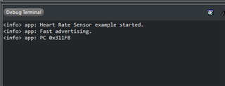

    I guess the offset is different compared to the hard fault handler because, on an assertion, the program goes through the app_error_handler() function first. I had to increment the stack pointer by two words instead of 12 in my case.
    How I tested it:
    1.  re-defined the app_error_fault_handler() like this:
    2. Inserted code to invoke the fault handler.
    3. Looked up the address from the debug console to verify that the PC indeed came from the error check added point 2.
    Line 244 in main.c is the line following the APP_ERROR_CHECK(1); in point 2.
