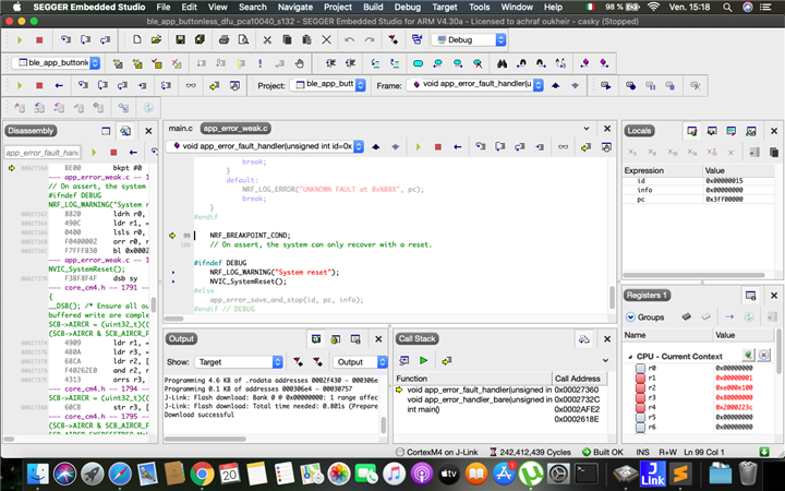

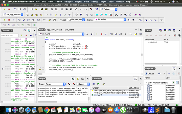

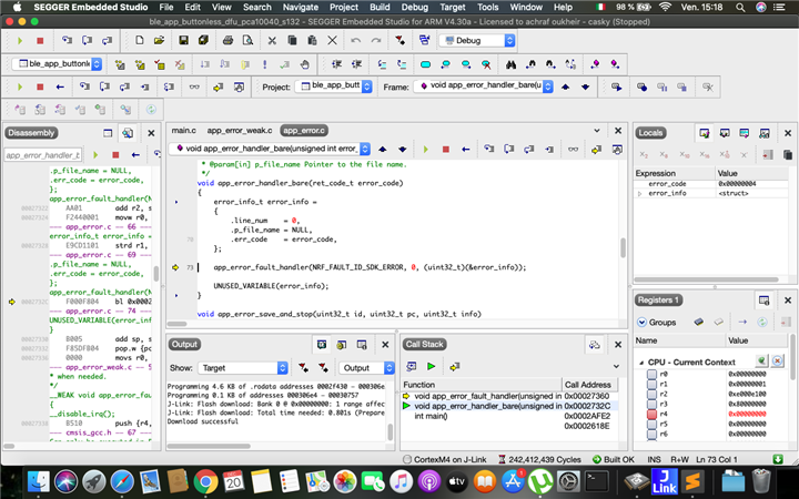

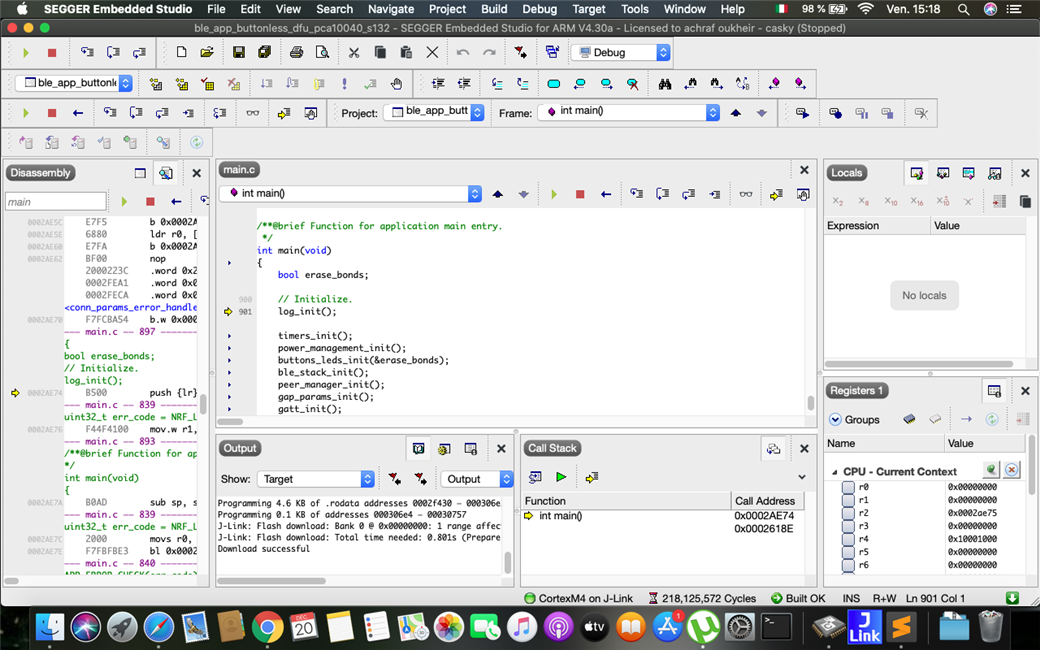

    otherwise I want to try your suggestion the buttonless_dfu example, but it doesnt work , i pick up the example of SDK15.0.0 cause Im working on it, with the nrf52832 is it because or ram or what , here is the picture of the segger results:
    here is how it begin it seems everythin okey , this the image before the execution:
    here is the image of the error:
    here is the error above :
    and the source of the error:
    if its possible to help with the button ,and the butonless , it will be great , otherwise nor probleme , the main thing it works
