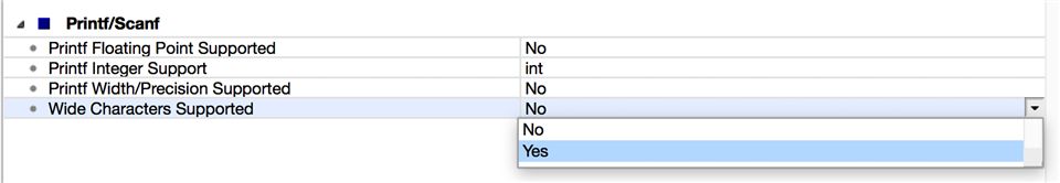

I noticed that there is an option in SEGGER studio to enable wide character support for printf/scanf.
But when I try to enable it I always get this error:
"/Applications/SEGGER Embedded Studio for ARM 4.16/gcc/arm-none-eabi/bin/ld:--defsym:1: undefined symbol `__vfprintf_short_float_long_wchar' referenced in expression"
