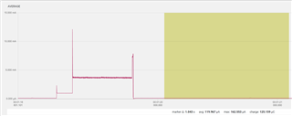

We are developing on the nRF52840-DK, using SDK 15.3.0 and FreeRTOS with tickless idle. The SoftDevice is disabled. Using the PPK v2.3.1 when our app is in System ON sleep mode, we are seeing power consumption spikes at regular ~1s intervals:
During this period our app is waiting on messages from a FreeRTOS message queue. At this time there are no other pending tasks:
xQueueReceive(msgQueue, &msg, maxDelayMS);
After maxDelayMS we enter System OFF sleep mode and the current drops for the duration:
NRF_POWER->SYSTEMOFF = 1;
I toggle an onboard LED in the vPortSuppressTicksAndSleep() function before and after System ON sleep. The LED toggles only once after the specified delay, which leads me to believe that the sleep logic is working as expected. After some experimentation, I found that the RTC wakeup interrupt configuration leads to the spikes. If I comment out this code, the spikes no longer occur, but of course the app never exits System ON sleep:

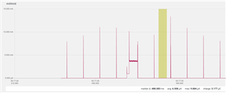

    I apologize for the very late follow-up here. We've since brought up our custom nRF52840 board and we are still seeing regular power consumption spikes at ~1s intervals when running under FreeRTOS, with tickless idle enabled, and using the vPortSuppressTicksAndSleep() function provided in the nRF52 SDK v17.0.
    We enter System ON sleep mode by waiting forever on a FreeRTOS task queue. Using the PPK, this is what we see when that happens:
    My understanding is that the spikes are related to the RTC wakeup configuration I described above.
    Changing the value of configEXPECTED_IDLE_TIME_BEFORE_SLEEP doesn't seem to help. As a test I bumped that value up to 2000 and the resulting power draw was much higher and constant.
