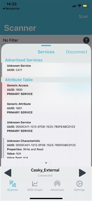

I'm working on the nrf52832 and sdk15.0.0 , I made my first custom perihperal with custom services, and now i want the device to be connected only to the first device (mobile phone) and after add the possibility to add another one with a button for example, so first i did some research and i found that my solution is with whitelist,
how to integrate it or add it . please explain to me as a beginner.

    I tested the ble_app_bms example (Bond Management Application), to see how this played out on iOS (iPhone X).
    When connecting to the ble_app_bms example in nRF Connect, I'm asked to confirm that I want to bond with the device.
    See attached screenshots:
    Sorry that the text is in Norwegian. But when connecting, the phone asks to confirm that the device bonds to my iPhone.
