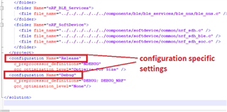

  • Hi, please open your *emProject in a text editor to try and see if you can spot other configuration differences between "Release" and "Debug".  The Release configuration should obviously have consumed less memory.
