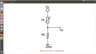

I am trying to connect thermistor with the ADC pins of nRF.
I use the steinhart formula to calculate the temperature in degree celcius. I used a voltage divider bias circuit where R1 is my thermistor and R2 is 10K ohms and I attach the output to the NRF adc pin.
Now , I use this formula Rt =R0 * ((adcMax / adcVal) - 1)
where Rt is the resistance of thermistor at particular temperature
R0 is 10K ohms
adcMax is maximum adc values
adcVal is the output adc value
I also want to convert Rt into its logarithm (ln in math) thus ,
logRt = log(R0 * ((adcMax / adcVal) - 1))
after which steinhart is 1/T = A + B*ln(R) + C*(ln(R))^3
After I tested this I get an accuracy issue of +20 DEGREE celcius in my output.
But in this case,
Vs is source voltage = 5V
Vo is the output voltage (depends on the output)
assuming Vref = Vs ( vref is reference adc voltage)
the above formula is applicable. But Iam giving Vs as 5V and I dont know how change my Vref to the same.
What can I do in this issue ?
PLease tell me how can I correct my +20 DEGREES error?
