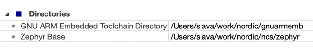

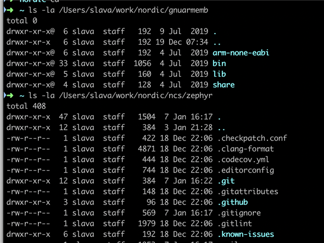

All was working on SDK 1.0. Now I have SDK 1.1 and new Segger and new nRF Connect and gnuarmbemb (I had a new computer, so did set up everything from scratch)
2> Compiling ‘isr_tables.c’
1> Remove /Users/slava/work/nordic/ncs/nrf/samples/nrf9160/gps/build_nrf9160_pca10090ns/spm/zephyr/zephyr.elf
1> Linking ‘zephyr.elf’
1> Post-link command
Build failed
However, using west directly is working fine:
➜  gps git:(d3130d77) ✗ west build --board=nrf9160_pca10090ns -d build_nrf9160_pca10090ns
-- west build: build configuration:
       source directory: /Users/slava/work/nordic/ncs/nrf/samples/nrf9160/gps
       build directory: /Users/slava/work/nordic/ncs/nrf/samples/nrf9160/gps/build_nrf9160_pca10090ns
       BOARD: nrf9160_pca10090ns (origin: CMakeCache.txt)
[0/1] Re-running CMake...
-- Using application from '/Users/slava/work/nordic/ncs/nrf/samples/nrf9160/gps'
Zephyr version: 2.0.99
-- Build files have been written to: /Users/slava/work/nordic/ncs/nrf/samples/nrf9160/gps/build_nrf9160_pca10090ns
[167/295] Linking C executable spm/zephyr/spm_zephyr_prebuilt.elf
           FLASH:         32 KB        48 KB     66.67%
            SRAM:        5424 B        64 KB      8.28%
        IDT_LIST:          40 B         2 KB      1.95%
[289/295] Linking C executable zephyr/zephyr_prebuilt.elf
           FLASH:      113980 B       976 KB     11.40%
            SRAM:       19644 B       128 KB     14.99%
        IDT_LIST:         120 B         2 KB      5.86%
[295/295] Generating zephyr/merged.hex
Merged /Users/slava/work/nordic/ncs/nrf/samples/nrf9160/gps/build_nrf9160_pca10090ns/spm/zephyr/zephyr.hex
Merged /Users/slava/work/nordic/ncs/nrf/samples/nrf9160/gps/build_nrf9160_pca10090ns/zephyr/zephyr.hex
Not sure where to look anymore or how to get more precise and details error mesage...

  • Could you try moving the gnuarmemb folder closer to the C: drive to shorten the path. I know others have experienced problems when certain paths are too long.
  • Hi Heidi.
    Moved it to /opt/gnuarmemb and it still gives same error Disappointed
