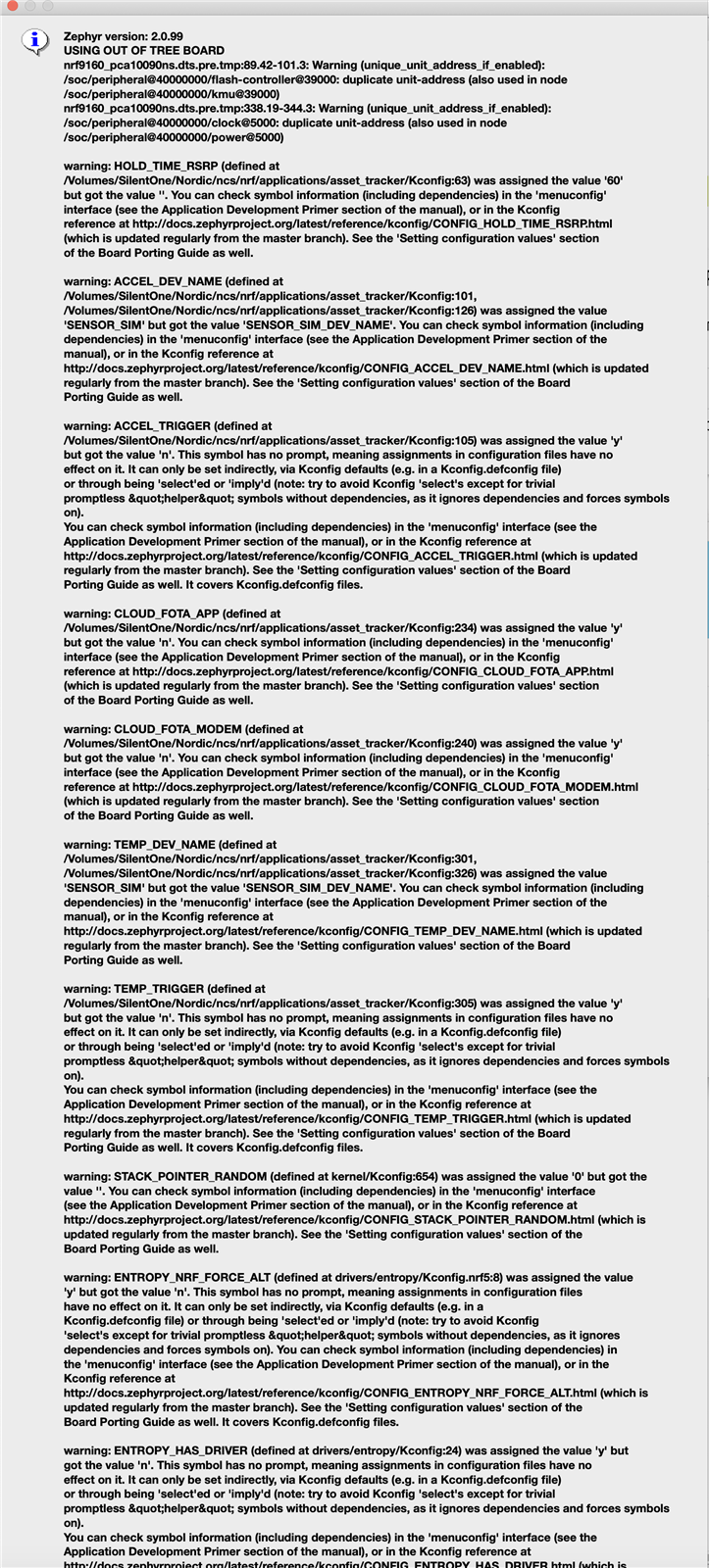

I'm trying to make a "simple" change to the asset_tracker project so that it will send the reporting data to my own server instead of the nRF cloud.  However, I am unable to build the provided asset_tracker code.  After many, many hours of work required to get the environment up and running, the following build error is displayed:

  • jkase said:
    The output I showed you is from SEG 4.30c, so yes, it's installed.
    And to verify, does it say the following in the top of the window:
    jkase said:
    I am trying to build the sample source code for asset_tracker, with no modifications.  That results in the error listed.  If have not begun to modify the source, since I always like to build the sample and install it before I make changes.
     These are not errors, these are warnings. If you do get errors, it will say error and print in the output window of Segger Embedded Studio. If you do have any errors, please copy-paste from the output.
