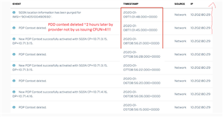

    Looking at the connection log of our provider (1NCE.com) we see that the connection will simply not closed by the not returning CFUN=4 command. So CFUN=4 does not return and not iniate any connection disconnect on provider side. After some time (2h in our example case) the connection gets closed by the provider but the nRF9160 AT socket waits forever. Any UDP sockets are NOT closed before using CFUN=4  will be reused after wakeup in our implementation - this works most of the time.
    In our real implementation we use timeouts on waiting on the AT socket and so we know that the modem power domain flag is set to OFF (NRF_POWER->POWERSTATUS) after CFUN4 did timeout.
    For us it looks like the modem fw seems to "forget" to work on CFUN=4 and does consequently not answer to the AT command - BUT the modem power domain gets turned off..
