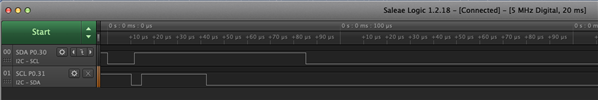

I am attempting to write a basic I2C program using Zephyr, but I am currently unable to sent a single byte over I2C. Am I doing something wrong? I'd prefer not to use the nrfxlib.

Platform: nRF5340 PDK
SDA: P0.30
SCL: P0.31

Waveform:
  • First the HW related questions, do you have pull-ups turned on on the GPIOs? or do you have external pull up resistors? and what i2c device do you have connected to the bus?
    Is i2c_burst_write() supported by the nrf5340? read https://docs.zephyrproject.org/apidoc/latest/group__i2c__interface_gae57ea5a1b4059e0d03d3bc068288de1f.html

  • After more debugging, I found that the location in which the code is failing is when the i2c_nrfx_twim.c driver calls k_sem_take in the following code. In the snippet it is line 36. It seems to work everytime if I step across that line with the debugger. I think there is somehow a timing issue.

  • Is there any code running on the network core?
    It might be that the network core is using the serial peripheral for e.g. logging, which would cause problems.
    You can try to "erase all" from the "Programmer" application in nRF Connect for Desktop to make sure that there is nothing running on the network core.
    While it seems that the i2c_scanner sample has been removed in NCS v1.2.0, the first transaction in the bme680 sample seems to work as expected (I do not have access to a bme680 at the moment, so testing the sample properly is a bit hard).
  • When I was running my application core code, my network core was running the HCI example. I don't think it had any use for the I2C busses, but I'm not sure.
  • It wouldn't have to use I2C for it to be a problem. The nRF uses the same peripheral for both UART, SPI, and I2C, so if you use the peripheral for UART, you will not be able to use it for I2C. In addition, on the nRF553, some peripherals can be used by both cores. Therefore, if the network core uses the same peripheral that you want to use for I2C for logging over UART, you will have a problem.
