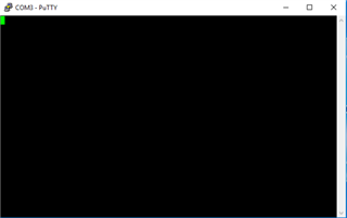

    I just tried putty in my friends laptops nothings happend i cliked on open nothing happend just a blank page
    even if im pressing any letter or digit key on the PC keyboard

    The reason you're not seeing anything when using the laptop and PuTTY I'm guessing is because you've set the UART pins to 15 and 17, and these must be set to 8 and 6 in order to print to the COM port.

    I just changed 8 and 6 , but nothing happend of course , because whats the relation between 8and 6 pin to the usb serial (COM port). Im seeing a blank page on the putty as my previous reply.
  • Hi
    Sorry, a little mix-up there. Using pins 8 and 6 are what is connected to the COM-port on the DK, but seeing as you're using a custom board, that's likely not the case for you. How is your custom board connected to the computer in your instance? The nRF52832 does not have a USB peripheral, so if you want it to work as a USB device you will have to use a USB-to-UART chip or cable.
