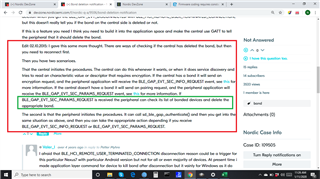

So we find-out a solution for these by referring https://devzone.nordicsemi.com/f/nordic-q-a/9506/bond-deletion-notification  this nordic ticket. Please look the marked portion of screen shot
we are following the first scenario.

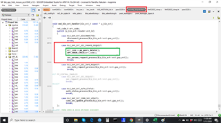

So based on these ticket .After the central(pc) and peripheral( our mouse) connected and also if the central sends pairing  request  and the peripheral application receive the BLE_GAP_EVT_SEC_PARAMS_REQUEST event  we  deleting the bonding information from  nrf52832.Look the screen shot below.
It is an effective way but it showing some issue if we connected on multiple pc without removing it.

  • Hi Nandhu,
    Please disregard the information you have been looking at before, as that is both outdated and irrelevant for what you want to achieve. The Peer manager library, which is responsible for handling bonding information in SDK 15.3, has support for the functionality you want. You can allow the nRF to bond again with a peer that has deleted the bonding information by adding the following case to the handling of peer manager events in your application (typically in a function called pm_evt_handler() in SDK examples).
            case PM_EVT_CONN_SEC_CONFIG_REQ:
                // Allow pairing request from an already bonded peer.
                pm_conn_sec_config_t conn_sec_config = {.allow_repairing = true};
                pm_conn_sec_config_reply(p_evt->conn_handle, &conn_sec_config);
            } break;
    This is all you need to change since everything is handled for you by the peer manager.

  • THANKS EINAR  ITS WORKING FINE NOW
