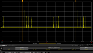

We are trying to get low average current consumption on the nRF9160 DK without success.
The floor current between modem active time is ~60uA, which is fine. But the average current when connected to the network (idle, no TCP/UDP data exchange) is high: ~1.9mA for Cat-M1.
For the Cat-M1 network we have not been able to get eDRX. The modem is active (measured on COEX2 pin) every 640ms and stays active for 48ms (see attached image).
Cat-M modem active time
If the cell/network does not provide eDRX is there no way for us to increase the intervals and lower the power (alter DRX?)?

See attached image of NB-IOT modem duty cycle. Is the waveforms as expected? It seems the radio is active a lot of the time in both Cat-M and NB-IOT and thus drawing a lot of power?

  • Hi, seems like you are not getting into eDRX idle mode. If you enable eDRX through the AT command +CEDRXS in mode 2, you will get notifications from the network saying which parameters you got. You can also read the parameters directly using +CEDRXRDP. What is the network reporting back?
    We've gotten reports from other customers saying that the Telia network in Sweden is not really supporting eDRX. You should contact Telia and ask. You can also do a modem trace and post the results here. Then we can analyze and see what is going on. Here's a guide: https://devzone.nordicsemi.com/nordic/nordic-blog/b/blog/posts/how-to-get-modem-trace-using-trace-collector-in-nrf-connect
    In Sweden the iBasis SIM card is only working with Telia, and it's in roaming mode. Telia might have chosen to support less parameters in roaming mode. Like PSM mode is probably not supported.
    I think the best thing for you now is to get a native Telenor SIM card to do the testing.

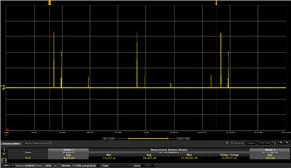

    This should cut the current significantly. I don't have the possibility to measure on NB-IoT at the moment, but I'm attaching some plots for CAT-M1, to show you the expected numbers for eDRX cycle: "0010", and PTW: "0011" or "0000". Both with and without SIM card current:
    20,48 eDRX, 4x PTW cycles, including SIM:
    20,48 eDRX, 4x PTW cycles, excluding SIM:
    20,48 eDRX, 1x PTW cycles, including SIM:
    20,48 eDRX, 1x PTW cycles, excluding SIM:

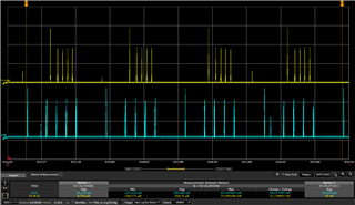

  • Hi, sorry for the late response. I've been able to do some measurements on NB-IoT now. Below plots show 20.48 second eDRX cycle and PTW="0011", average current and zoomed in on one paging event.
    MattiasE said:
    It seams strange that NB-IOT should consume more power when no data is transferred? It can understand that this is the case when transferring a lot of data, but I don't think this should be that case during idle periods?
    As you can see the total charge for one DRX paging is about three times as much for NB-IoT compared to Cat-M1. This is because the radio has to be listening for a longer time for the paging event. So it's not using three times as much during "idle periods" but since the total average current is dominated by the radio current the average current will be significantly higher if the radio has to be in RX mode for a longer time.

  • Do I understand correctly that the yellow graph is CAT-M and the blue NB-IOT?
    Your numbers look good. However, I'm not able to reproduce them.
    Connected to Telia with NB-IOT eRDX 20.48s (+CEDRXRDP: 5,"0010","0010","0011") I get 2.47mA
    average current (idle current is ~60uA, so I get everything to sleep correctly). It is far from your numbers. See attached images.

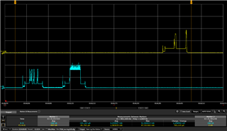

    When comparing my zoomed in paging event to yours, we can see that I get 3 high current periods (after the first bumpy) where you only get one. Do you know why that is so? I feel like this is probably one of the reasons I get so high current consumption. Is that something you/me can control or is that due to some network related setting?

  • Sorry, forgot to mention, yes, the blue is NB and yellow is M1.
    I agree that this is probably the reason for the higher current consumption you see. Not really sure why the paging window is so long. I will have to forward the question internally.
  • I got this answer from the protocol expert, regarding the three RX windows:
    Telia network has DL gaps present in eNb configuration that causes the paging reception to be split into three "blocks" in current consumption measurements. In broadcast SIB2-NB:
    • pcch-Config-r13
    • defaultPagingCycle-r13: rf256 (1)
    • nB-r13: oneT (2)
    • npdcch-NumRepetitionPaging-r13: r256 (8)
    Blue field means that one paging is repeated over 256 valid subframes. Timewise this is more than 256ms as there are non-valid subframes for NPDCCH in anchor carrier like synchronization signals and broadcast channels, actual reception is more than 350ms.
    Another parameter set in SIB2-NB:
    • dl-Gap-r13
    • dl-GapThreshold-r13: n256 (3)
    • dl-GapPeriodicity-r13: sf256 (2)
    • dl-GapDurationCoeff-r13: oneHalf (3)
    This shows that downlink gaps are used if reception is 256ms or more. In the Telia configuration DL gaps are in effect and the actual gap is half of the 256ms periodicity. This will make reception gaps to the paging monitoring, dividing the reception into three blocks in Telia configuration.
    In the customers plot, the first two similar sized blocks are 128ms of reception separated by the configured DL gap. The third block which is a bit smaller is the rest of the valid subframes for paging monitoring also separated with the DL gap.

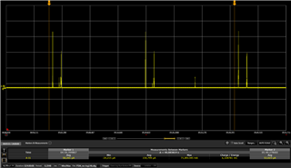

    Cat-M no eDRX: 0.97mA
    Cat-M eDRX 0001 (10.24s): 0.40mA
    Cat-M eDRX 0010 (20.48s): 0.23mA
    I have attached some images of the current profile, for other users information.
    Cat-M no eDRX:
    Cat-M eDRX 20.48s:
    Cat-M eDRX 20.48 zoomed in on first "bump":
    Cat-M eDRX 20.48 zoomed in on second "bump" (same as third):
