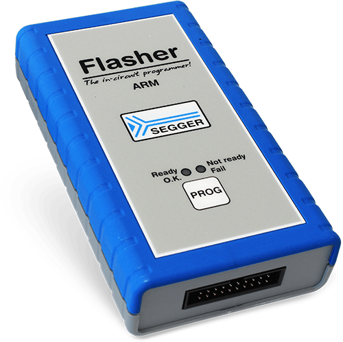

Basically my goal is to view logs through nRF52840 chip SW pin -> segger flasher box -> laptop RTT viewer program.
The nRF52840 is put on our custom board so it does not have an ARM chip helping with UART, hence this effort to view logs on RTT viewer.
The flasher box looks like this:

We have used the flasher box to download hex to our custom board and it's working, so shouldn't be any hardware problem there.
Segger version: 4.30c,  RTT viewer version V6.60e
Can anyone shed some light on this issue? Many thanks.
