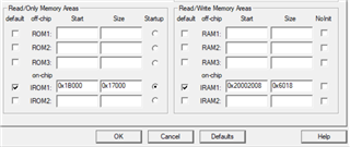

I am using NRF51822 SDK12 S130, I have increased my code and encountered a crash right at the beginning, I debugged it as follows -
I increase an integer (uint32) array I use for debugging this problem from size 5 to 6 it crashes(uint32_t debug_z1[5]; to uint32_t debug_z1[6];), and the program stops working,
this is the program size reported before the increase -
 Program Size: Code=60768 RO-data=1488 RW-data=848 ZI-data=8368 (with uint32_t debug_z1[5] ) works fine
this is after the increase -
Program Size: Code=60768 RO-data=1488 RW-data=848 ZI-data=8360 (with uint32_t debug_z1[6] ) doesn't work
This is my code size,
My RAM memory allocated is 0x6018, so I don't understand how I have a problem, To my understanding I have enough RAM,
Please help me, any suggestion on how to proceed will be very much appreciated!
Thanks!
