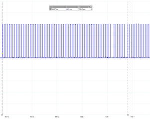

I'm using BT840XE module and ATT_MTU Throughput Example with S140. My goal is to measure maximum data transfer speed between module and different phones. Module acts as peripheral and phone as master. For phones, I use nRF Connect app.
Problem is that i get different data transfer speed with different phones. I measure how many data packets are send per connection interval. Every time BLE_GATTS_EVT_HVN_TX_COMPLETE arrives GPIO pin is toggled. And i see that some phones accept more packets per connection interval than others. Please see attached pictures. Samsung J7 accepts only 5 packets per connection interval and Google pixel a3 accepts packets in whole connection interval.
Settings:
Connection interval: 100ms
NRF_SDH_BLE_GATT_MAX_MTU_SIZE 247
NRF_SDH_BLE_GAP_EVENT_LENGTH 300
My question is what could cause that huge differences in delivering data packets to phone? Maybe phones has some kind of limitation?

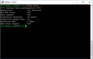

    Is there some function in SoftDevice API to request increasing Event Length?
    If phone accept larger MTU this means DLE is enabled?
    My goal is to deal with phones with at least Bluetooth 4.2 (My Samsung has 4.2). I tested iPhoneX also and it behaved similar to Samsung J7.

  •     ret_code_t err_code;
        ble_opt_t  opt;
        memset(&opt, 0x00, sizeof(opt));
        opt.common_opt.conn_evt_ext.enable = 1;
        err_code = sd_ble_opt_set(BLE_COMMON_OPT_CONN_EVT_EXT, &opt);
    I copied this from the ble_app_att_mtu_throughput example. I normally don't recommend this example as a starting point, because it is quite complex, and can act as both a peripheral and central during runtime. However, you can see how the different settings are being set based on the incoming CLI commands.
    when you write a command, you typically get a response on the CLI. search for this response in the project, and you will find the function that will set the configuration.

  • I did some tests and best throughput results are with 15ms connection interval. nRF receives 3 BLE_GATTS_EVT_HVN_TX_COMPLETE events in one connection interval. As i understand that means 3 notification packets are sent in connection interval?
    If connection interval is bigger than 15ms same 3 BLE_GATTS_EVT_HVN_TX_COMPLETE  events occurs. So increasing connection interval doesn't help in this case.
  • What example are you working from?
    What is your NRF_SDH_BLE_GATT_MAX_MTU_SIZE?
    What is the length of the notifications you are sending?
    When gatt_evt_handler() is called, what is the p_evt->params.att_mtu_effective - OPCODE_LENGTH - HANDLE_LENGTH? It should be printed in the log:
  • 1. I'm working with ATT_MTU Throughput Example.
    2. NRF_SDH_BLE_GATT_MAX_MTU_SIZE  247
    3. I'm sending 244 length uint8_t array
    4. p_ctx->max_payload_len =
                p_gatt_evt->params.att_mtu_effective - OPCODE_LENGTH - HANDLE_LENGTH;
    after that line max_payload_len set to 244.
