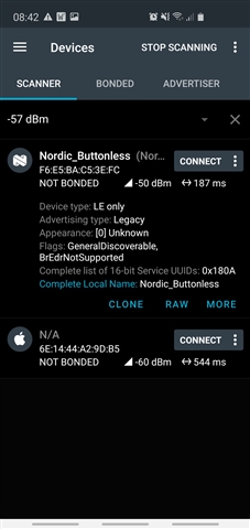

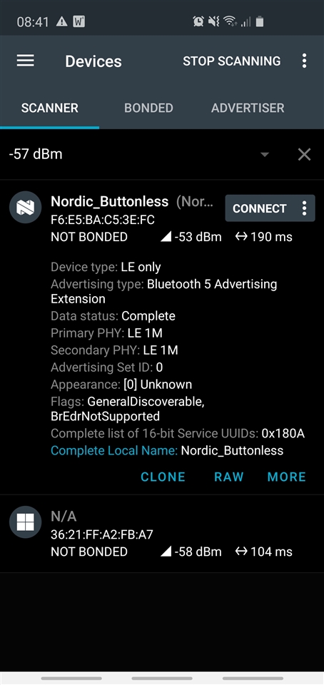

  1. In addition to the above link, in this function: advertising_config_get(), I also needed to set
    p_config->ble_adv_extended_enabled = true;
    only then I am able see the correct properties on my smart phone that it is extended advertising. See attached pictures taken from my phone.

Below picture when the ble_adv_extended_enabled = true
Below picture when the flag ble_adv_extended_enabled = false
