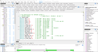

nRF52 DK GPIOTE interrupt stops working after approx 400ms after startup.
I am using SDK 15.3, SES 4.30 and softdevice 132 with the ble_app_uart_c as the core functionality for my system.
I've read many dev support threads about this issue and most seem to point to using high accuracy with GPIOTE.  I have high accuracy enabled.  Attached is my code:

  • Can you search through your code if you may be calling nrf_drv_gpiote_init() somewhere else? Can you set a breakpoint shortly after init the GPIOTE module and read out the GPIOTE peripheral registers and compare when it doesn't work? Also, check out if the GPIO pin configuration may have been reconfigured by other functionality in the code.

  • Hi Kenneth,
    I've attached the GPIOTE registers here:
    Register values while WORKING (first 400ms after startup)
    Register values while NOT working... (after the initial 400ms)
    GPIOTE Registers - NOT working
    I believe that I've deactivated all button functionality.  From what I can tell, there are no other calls to nrf_drv_gpiote_init().  No other calls in any other files are being linked in.

  • Hi Kenneth,
    Since this code is setting an irq for an external Dallas temperature device, I'm not sure how I can give you a copy of the code that you can run directly.  However, I've setup 4 breakpoints and took 4 screen shots that show the GPIOTE registers after each.  You can see what is going on from these.
    What to do next?
  • Kenneth,
    When I setup a GPIOTE interrupt, how do I know what interrupt is being used?  It's looking to me that my GPIOTE interrupt is being disabled by some other module such as: ble_stack_init(),  gatt_init(),  nus_c_init()  or scan_init().  If I run the code continuously before enabling  these functions, the interrupt works fine.  This would account for the 400ms run time at startup.

  • Kenneth,
    I give up.  The zipped file is attached. Unzip in your examples folder. It will run on nRF52-DK, SDK 15.3, SES 4.3. If you change line 927 to have an internal pullup, you should be able to trigger the gpiote interrupt with a ground wire on P0.25 on P4 of the dev board. It is set for a LoToHi transition on this pin. Also comment-out the init function void perfect_shower_init(void) at line 1255.
    In a nutshell, what I am trying to do is to run the Dallas ds18B20 temperature sensor continuously.  It takes 172ms per conversion so I can't use a delay function so I set up it's OneWire pin as an interrupt on pin P0.25.  This pin will be held low by the DS18B20 while the conversion takes place then an external pullup resistor on our board pulls it high.  (Hence the internal pullup requirement.)  When an interrupt is generated the handler goes to read the temperature probe data.  First it disables the interrupt so that when I read the probe the act of reading doesn't generate more interrupts.  After the temperature data is read then another temperature conversion is immediately initiated and the interrupt is re-enabled and I go off to do other things for another 172ms.
    The problem is that this process stops working after about 400ms.  The last activity I see on the d_temp_irq line falls in line with my perfect_shower_init() initialization routine. After this, I never get any interrupts from the GPIOTE system.  This seems to coincide with the ble_app_uart_c functions starting up.
    Thanks !PerfShwrValve.zip
