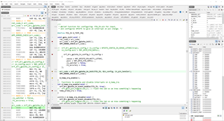

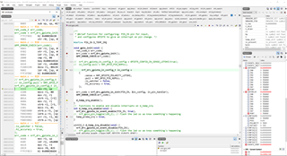

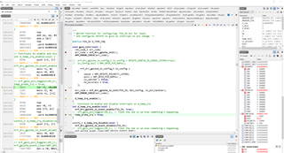

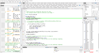

  • Hi Kenneth,
    Since this code is setting an irq for an external Dallas temperature device, I'm not sure how I can give you a copy of the code that you can run directly.  However, I've setup 4 breakpoints and took 4 screen shots that show the GPIOTE registers after each.  You can see what is going on from these.
    What to do next?
