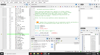

My custom board with NRF52810 is done and I'm now trying to get some examples working. I am adapting blinky_s132 in SES. To do this I edited the project options including disabling the FPU, defining BOARD_CUSTOM, chaning the device definition to NRF52810_XXAA, and some other changes. I've attached the SES project file. I also opened this project file in a text editor and changed  ...
arm_target_device_name="nRF52810_xxAA"

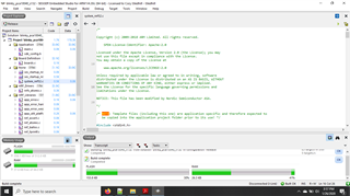

I also created a custom_board.h which I have attached. The program compiles correctly and programs fine but when debugging it seems to get stuck in a trap. I don't think SES has registered that I'm using 52810 instead of 52832 as can be seem by the flash and ram usage . Can you help me resolve this?

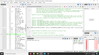

    And is the preprocessor macros for the BLE GATTS example:
    APP_TIMER_V2
    APP_TIMER_V2_RTC1_ENABLED
    BOARD_CUSTOM
    CONFIG_GPIO_AS_PINRESET
    FLOAT_ABI_SOFT
    INITIALIZE_USER_SECTIONS
    NO_VTOR_CONFIG
    NRF52810_XXAA
    NRF52_PAN_74
    NRF_SD_BLE_API_VERSION=7
    S112
    SOFTDEVICE_PRESENT
    The only differences I see are...
    APP_TIMER_V2
    BSP_DEFINES_ONLY
    S112
    SOFTDEVICE_PRESENT
