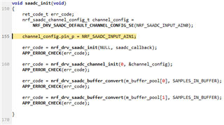

I'm not familiar with C language, I tested the saadc example in SDK, it worked well in P0.02
But I dont see how they set CH[X].PSELP or CH[X].PSELN (V(p) and V(n)) in main.c
I dont know how to implement this code to work with other ADC pins.
Please help me with it and correct me if I was wrong.
I'm using nrf52 dk and segger embedded studio.
Cindy
  • Hi Cindy
    These parameters can be found in the channel_config struct, which is used to initialize the ADC channel inside the saadc_init() function.
    By default this function will just use the default settings, defined by the NRFX_SAADC_DEFAULT_CHANNEL_CONFIG_SE(PIN_P) macro, but you can override the various parameters after initializing the struct if you like.
    As an example, to override the positive pin, you just run the following code:
    channel_config.pin_p = NRF_SAADC_INPUT_AIN1;
    Then the full saadc_init() function would look like this:

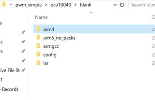

  • Hi Cindy
    You can just replace "LED_1" with the GPIO number of your choice.
    For instance, to use P0.08 set it like this:
    #define OUTPUT_PIN 8
    The duty cycle is set by calling the pwm_update_duty_cycle(uint8_t duty_cycle) function with a number between 0 and 100.
    Best regards
    Torbjørn

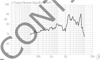

    Could it because the speaker doesn't get enough current?
    https://media.digikey.com/pdf/Data%20Sheets/CUI%20Inc%20All%20Brands%20PDFs/CCV-084B16-SMT.pdf
    here's the datasheet of the speaker I'm using.
    Thanks for your help.
    Cindy
  • Hi Cindy
    If you need to generate a square wave of varying frequencies I don't think the PWM peripheral is the best choice, since the PWM is designed for applications where you use a fixed base frequency and modulate a signal on top of this.
    Instead it should be enough to set up the TIMER, PPI and GPIOTE modules to toggle a pin when the timer overflows, and then you just change the compare value of the timer to change the frequency of the pin.
    I made an example showing how to do this a while back and I will see if I can find it, hopefully by tomorrow.
    Are you saying the speaker is louder when you use it with Arduino than when you use the Nordic kit?
    Some speakers need a particular hardware configuration to get optimal performance, but this is normally mentioned in the datasheet.
