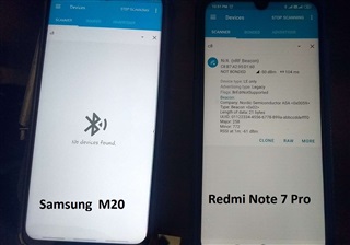

Hello all,
I am running "ble_app_beacon" example code in nrf52832. when i'm using samsung and honor mobile phones the nrf Connect application is not showing the beacon, but in other phones the application is showing the beacon. I can't understand what is happening in samsung mobile please solve my problem so that the beacon in shown in all mobile phones.

  • Your source main.c looks the same as mine.  Are you sure the phone is not connected to another BT device like a Tile or headset while you are performing the test?  I installed the Tile app and connected a Tile device and it seems to interfere with my app operation when transferring data during a connection but no problems during scanning from nRF Connect.  You can perform a factory reset on M20 and see if it fixes the problem.
