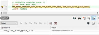

  • I reproduced the issue with the hex-files from Leo as well. How exactly did you change the scheduler queue size? As far as I can see, this is still 16 in the latest project you uploaded (nRF5_SDK_15.3.0_59ac345_PC_Connect_200505.rar):
    // In ser_conn_handlers.h:
    /** Maximum number of events in the application scheduler queue. */
    #ifdef S112
    #define SER_CONN_SCHED_QUEUE_SIZE             8u
    #else
    #define SER_CONN_SCHED_QUEUE_SIZE             16u
    // In main.c:
    APP_SCHED_INIT(SER_CONN_SCHED_MAX_EVENT_DATA_SIZE, SER_CONN_SCHED_QUEUE_SIZE);
    And when debugging, it is set to 16 when app_scheduler is initialized:
