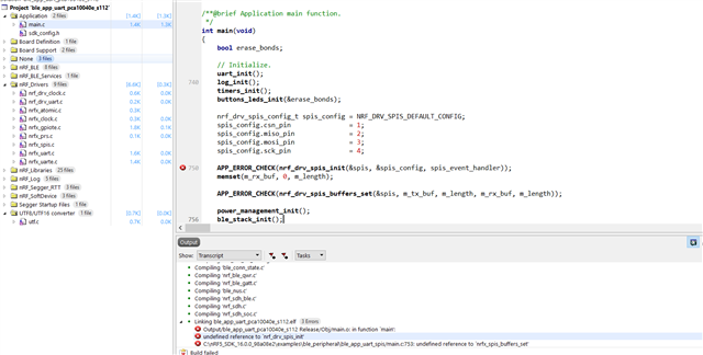

I am trying to implement SPI slave on NRF52810. I added nrfx_spis.c and enabled below macros in sdk_config.h
NRFX_SPIS_ENABLED  and NRFX_SPIS0_ENABLED to 1
Still,I am getting below error
'NRFX_SPIS0_INST_IDX' undeclared here (not in a function); did you mean 'NRFX_SPIS_INSTANCE'?
Any idea what I am missing here?

  • looks like you did not enable the below drv define.
    #ifndef SPIS0_ENABLED
    #define SPIS0_ENABLED 1
  • This helped me a bit.
    Now complaining about some other function. I have that defined in nrfx_spis.c

  • Is there any graphical tool to config the driver?
    I followed the peripheral example for SPIS which is for NRF52832. In the sdk_config.h there are a few headers for SPIS.
    one is NRFX_SPIS_ENABLE and another one is SPIS_ENABLE. Which one I should us? What is the difference between these two?
  • I do not see nrfx_spis.c files added into your project. also I cannot find the definition of  spis_event_handler anywhere.
    Please use the CMSIS configurator tool to have GUI version of selection . Download the file, unzip it and open the jar Java file. You can open to select the sdk_config.h and it will give you a GUI editor that makes your life a bit easier to select.
