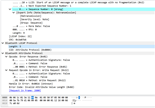

Description of the problem (seen in wireshark)

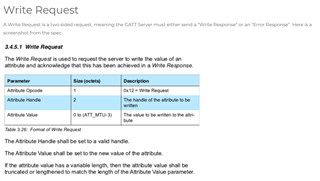

Client : write request (0x12)
Server: Rcvd Error Response - Invalide Attribute value length ,
I don't understand the problem because i think the answer is provided by the nrf framework.
I didn't write any code to answer to the write.
i only indicate the datas of the characteristics written by the client
with an indication
according to me the answer is in the specification (0xD)
how can i answer the code 0xD?
Is it provided by the framework?
thank you
    I don't think you are looking in the right place.
    From your second screenshot, the Sequence number is wrong. This means that the device that sent this message is using the wrong sequence number because the other device (or the sniffer, actually) didn't pick up the last packet. This requires a retransmit, but that is not something that you have to worry about, because the SoftDevice (the Bluetooth Stack) will handle that for you.

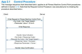

    My aim is to connect an home trainer to Zwift.
    I follow the specification of FTMS (buetooth org)
    In this specification there is a control point and the client (Zwift) write into it.
    The client writes with a write request. it's in the FTMS specification.

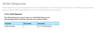

    And the server sens a "write response". I think it is a 0x13 according to the generic specification I gave you.
    Added to that, I answer an indication . I put the code of the indication in my programm.
    But i think the problem seen in wireshark is not caused by the indication but by the write response.
    Is the write response done by the framework?

    So I must reply to the client which write a request into a control point characteristic.
    And first of all I must write a response
    and after i must indicate the datas of the control point
    for the write response actuallly in my software i don't do anythink and for the indication, i indicate the values as described in the following specification

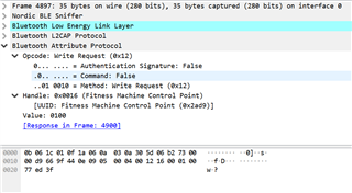

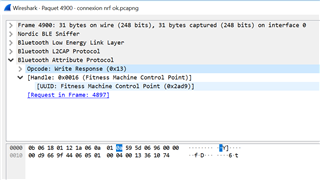

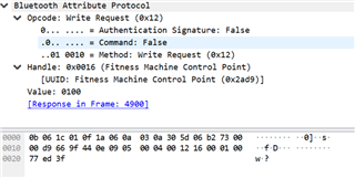

      I tried to write into the control point with nRFConnect
    And i think it works fine
    Here is the write request from nRFConnect:
    And here is the answer from the server (my software)
    we can see that the UUID is well decoded and the response provided by the framework (0x13) is sent by the server. I think it's OK.

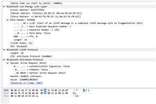

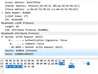

    But when I catch the write request sent by Zwift , i have this.
    How can I have a problem in my software if the sniffer cannot decode the request?
    and i see that exactly the same frame is sent every 2 or 3 seconds. so it's not a problem of radio because the sniffer see exactly the same bits sent by zwift.
    Do you have any idea to proceed?

    how do you explain that with nRFconnect i see a correct sequence with wireshark but when it is zwift, in wireshark it seem to have some errors.
    but i think it cannot be a problem of radio because Zwift send only exactly the same write request and it is only shown in wireshark with an error:
    Here is the write request sent by zwift:
    and here is the write request sent by nRFConnect (me)
    And how do you explain that with nRFConnect there is a good UUID detection with wireshark but not when the write is sent by Zwift?

    and here is the write request sent by me with nRFConnect:
  • Can you show me how you answer to it with the indication? And where you call sd_ble_gatts_rw_authorize_reply? You can show me some snippets or something.
    The indication will appear as a separate line, and not just part of a packet. To be honest, I don't know what you are trying to show me with the screenshots. Perhaps you can send the sniffer trace as a pcapng file? (default file type that it is saved as).
    Just to say something sensible about the latest screenshot, this is the packet from the central to the peripheral, containing the write request. The reply to that will not be in the same packet. This is only communication from central to peripheral.
