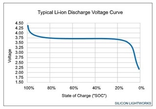

  • Hi
    Please see the picture below. This is a typical battery discharge graph. As power always must stay the same when powering a device, the current consumption will increase as the voltage decreases. As you can see, a battery's voltage drop is generally very low until the end of its lifetime, so the current consumption should be fairly stable throughout its life cycle. Generally, it is stated in a battery data sheet how long it will be able to supply X volts I believe, so you should look at that to get a better idea.
    Note that this is just a typical voltage curve, so it will likely differ depending on what battery you are using. Don't hesitate to ask if you have any further questions.
    Simon
