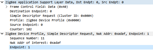

Originally, the Zigbee light_control examples ships with a bulb that can call the zb_bdb_finding_binding_target() function, and a light switch that calls zb_bdb_finding_binding_initiator() function. This allows the light switch to add the bulb to its binding table. Here are the corresponding WireShark packets, which shows the Simple Descriptor Request being sent using the Zigbee ZDP protocol. The request is sent from the switch to the bulb.
I am now trying to implement the reverse. Have the light switch call zb_bdb_finding_binding_target(), then call zb_bdb_finding_binding_initiator() on the bulb, in order to have the bulb add the switch to its binding table.
However, this does not work. I am using the CLI example in coordinator mode to query the bulb using the zdo mgmt_bind 0xXXXX command to see if there are any entries in the bulbs binding table, but it consistently shows the binding table to be empty.
There are no errors thrown inside the bulb or the switch, and the entire system (joining network, turning bulbs on and off, etc.) works just fine. One possible clue is when using WireShark, I can can see the bulb is never able to send the Simple Descriptor Request that is sent during a normal interaction. Instead, a default response is sent indicating an unsupported cluster. In addition to this, it is not being sent via the Zigbee ZDP protocol, but is instead using Zigbee HA.
