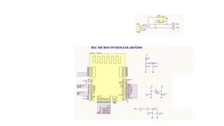

We are seeing a voltage of approx 1 volt on our USB connector when USB is not being used (VBUS).
We are using our device in a Wet environment; this voltage between GND and VCC on the USB connector is causing us problems in that electrolysis is occurring.
Electrolysis is causing oxidation of USB pins and "probably" eating away the USB connector.
We can fix this in HW by extra protection circuitry; but this requires a respin of our design.
Why are we seeing this parasitic (?) voltage; is it possible to turn this off?
Note we have no requirement to use USB properly, we just use it as a charging interface.
