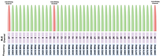

    Could you check these as well? With Q2, I mean the RF frequency output. These are the advertising frequencies that you should see:
