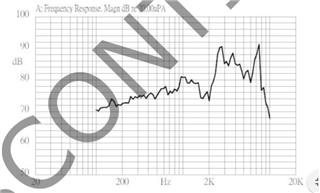

  • thanks, I tried this. now I'm kind of confused. I thought the buzzer isn't loud is because the frequency.
    now, it's still not very loud even after I change the frequency.
    https://www.mouser.ca/datasheet/2/670/cui%20inc._ccv-084b16-smt-1216976.pdf
    this the buzzer I'm currently using.

    this is the code I'm currently trying.
    I also tested this sensor on Arduino, it can be very loud with 1kHz, I'm not sure what went wrong.
    this is a very simple code I tried on Arduino.
    const int buzzer = 9; //buzzer to arduino pin 9
    void setup(){
      pinMode(buzzer, OUTPUT); // Set buzzer - pin 9 as an output
    void loop(){
      tone(buzzer, 1000); // Send 1KHz sound signal...
      delay(1000);        // ...for 1 sec
      noTone(buzzer);     // Stop sound...
      delay(1000);        // ...for 1sec
    will it because of the current?
