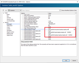

Moved to a new machine and now can't debug. I suppose I've overlooked something. First, Segger doesn't recognize that it has just compiled the app and asks to recompile.  Then I get an "Invalid ELF file" message referencing the SPM.  Any pointers on this would appreciated.  Thanks.
    We've been able to find the root cause. The order of the elf files is extremely important - they must be in the correct address order, as in the image flashed at address 0x0 must come first, thereafter the second lower image, and so forth.
    In asset_tracker this means the following order must be present in order for symbol loading to work correctly, and hence placing of breakpoints from source code.
    Please go to Project -> Options -> Debugger.
    And then change the order to this (see image below):
    Debug Symbols File [0]: $(ProjectDir)/mcuboot/zephyr/zephyr.elf
    Debug Symbols File [1]: $(ProjectDir)/spm/zephyr/zephyr.elf
    Debug Symbols File [2]: $(ProjectDir)/zephyr/zephyr/zephyr.elf
    Please try this and confirm that debugging now works in SES.
    Note: This workaround lets you debug your application but not mcuboot or spm, so it's only a temporary solution.
