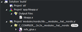

Thanks Didrik,
I added CONFIG_CPLUSPLUS=y and CONFIG_LIB_CPLUSPLUS=y in prj.conf
built it on Window SES. Project can be built but just not compile the .cpp file which is in CMakeLists.
what I tested is to use "hello world" in zephyr\samples\hello_world:
changed src/main.c to src/main.cpp, also in CMakeLists
Loaded project into SES, and the main.cpp is not in Project 'app/libapp.a' list, but main.c was there before modification:
build and run on nRF9160 DK board won't print "hello world" on terminal as main.c build does.
Did I miss something?
Thanks
I just tried myself, and it does indeed look like SES has some problems with C++.
However, the attached project worked fine when building from the command line.
Note that I had to disable (or rather, not set) CONFIG_LIB_CPLUSPLUS to make it compile.
Command line works, thank you.
do you know what is the problem of SES with C++? Command line build is not so convenient for us.
