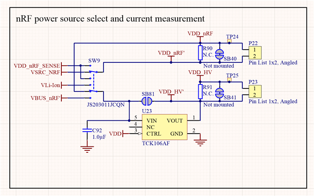

I followed all the steps as described in PPK User Guide v2.2:
1 - cut traces on the DK (SB40)
2 - installed the PPK on top of the DK
3 - Connected USB cable to DK
4 - Set the all 3 switches for the DK

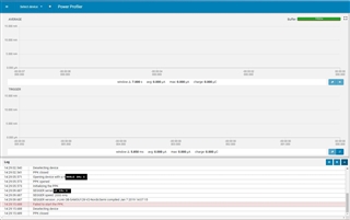

and after that there is an error "Failed to start the PPK"

UPDATE:
A subsequent attempt to connect cause
Error while setting up device. Error occured when open device long term. Errorcode: CouldNotCallFunction (0x9)
Lowlevel error: INVALID_OPERATION (fffffffe)
