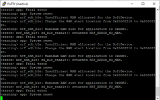

I am referring to this webpage https://github.com/bjornspockeli/custom_ble_service_example "Custom Service Tutorial", I followed all the steps mentioned on the webpage. But somehow I am not able to make it as functional. I am getting the following error.  I have changed RAM location in the .ld file but still, it's giving me the same error again and again. Is there anything I am missing. because somehow that .ld file is not reflecting the code. I have changed it to the following values but still giving me that change the RAM location to 0x2000220.
MEMORY
FLASH (rx) : ORIGIN = 0x26000, LENGTH = 0x5a000
RAM (rwx) : ORIGIN = 0x20002220, LENGTH = 0xdde0
Building code through IAR 7.8.01
SDK version 15.3.0
Board -nRF52832.
Softdevice - s132
Please help me to solve this.
