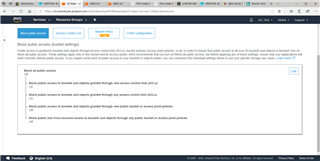

  • 1) I am running v1.1.0 of NCS.
    2) Per the link for setting up Aws S3 Bucket and as a result addressing the "Content-Range field is missing in the HTTP GET header"
    Here are the bucket policy settings
    And here is the content of the json file
        "Version": "2012-10-17",
        "Statement": [
                "Effect": "Allow",
                "Principal": "*",
                "Action": "s3:GetObject",
                "Resource": "arn:aws:s3:::mynrf9160fwupdatev2/*"
    3) I am able to put the url for the binary in a browser and it will pop up a message in the browser for downloading the file.
    I must be missing something simple
