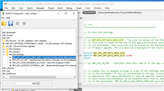

    And one more last question – What I’m missing (or is a bug ) from the attached picture: in sdk_config.h NRF_DFU_APP_DATA_AREA_SIZE shows 12288 which looks correct for me, while CMSIS show it as 3000 while still claims that units are bytes?

    12288 = 0x3000 i hexadecimal , the configuration app should be clearer on the format.
