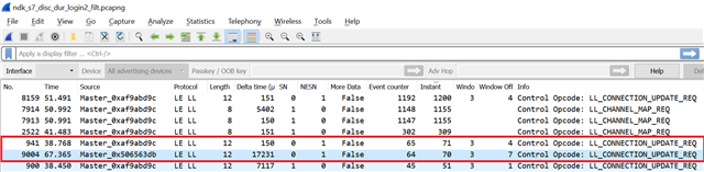

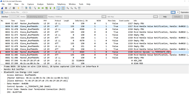

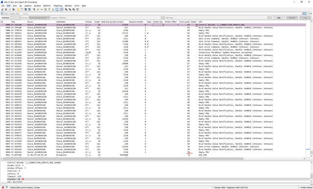

I observe a connection supervision timeout (HMI error code 0x08) in my Nordic firmware with certain Android smartphones (controller).
Additional info regarding GATT events: After the last connection parameter update and some GATT events the softdevice stops reporting BLE_GATTS_EVT_HVN_TX_COMPLETE and BLE_GATTS_EVT_WRITE.

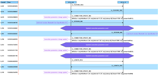

After exchanging the MTU request in GATT the controller sends data length update requests over GAP with
  • Max number of payload octets to receive of  251 bytes
  • Max reception time of 2120 us
  • Max number of payload octets to transmit of  135 bytes
  • Max transmission time of 1192 us (BAD CASE) and 2120 us (GOOD CASE)
