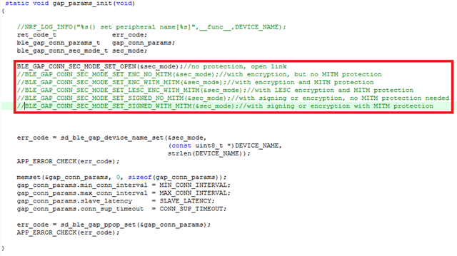

Q1: I add some code in advertising_data_set() to do fast advertising, is that correct ?
Q2: If  want to test current consumption under different  conditions (in red box) these conditions is work for test ?
thank's
Louis
