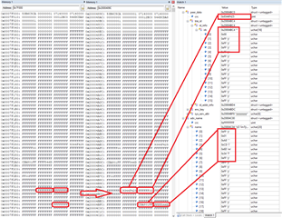

    Additionally, I found out that the check in settings_write() in nrf_dfu_settings.c which should prevent the bootloader settings page from being rewritten if not necessary, will get rewritten nonetheless because for whatever reason, some values change between reboots.
    The following screenshot shows on the left side the bootloader settings page as it is in flash and on the right side the s_dfu settings struct as it is in rame when settings_write is executed. There is only one reboot inbetween and there was no DFU activity whatsoever.  As you can see. peer_data.crc and peer_data.irk as well as the adv_name values changed. Why? To me, it looks like there is some strange memory corruption bug here, but I can't pinpoint where and why it happens.
