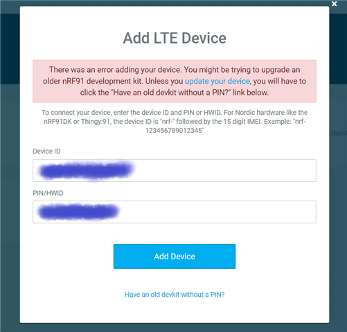

nRF 9160-DK. Asset Tracker. Can't seem to get connected to the network.
I have a new nrf 9160 DFK. I followed up the instructions from 'Getting Started Assistant' from the 'nRF Connect for Desktop' app. I was able to setup and build the asset tracker application. ANd flash it as well. I am using the tag v1.1.0. It looks like I am unable to register to a netwrok. I am using the iBasis eSim that came along with the kit. I also tried to add the device into the nrfcloud but I always get this error while trying to add the device. The sim however was added  successfully (which i think is the first step of adding the device). I am attaching the screenshot of the LTE Link Monitor app, the log file (asset tracker application) and the device add error from nrf cloud are attached. I also tried after updating the latest version of the modem firmware (mfw_nrf9160_1.1.1) but no success.

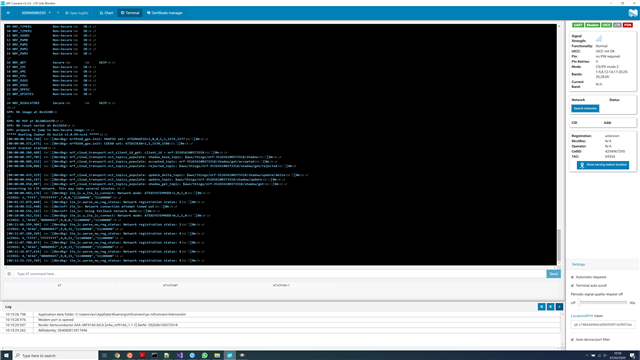

2020-02-07T09:15:26.758Z INFO Application data folder: C:\Users\ravi\AppData\Roaming\nrfconnect\pc-nrfconnect-linkmonitor
2020-02-07T09:15:26.833Z DEBUG App pc-nrfconnect-linkmonitor v1.1.1 official
2020-02-07T09:15:26.834Z DEBUG App path: C:\Users\ravi\.nrfconnect-apps\node_modules\pc-nrfconnect-linkmonitor
2020-02-07T09:15:26.834Z DEBUG nRFConnect 3.3.0 is supported by the app (^3.2.0)
2020-02-07T09:15:26.834Z DEBUG nRFConnect path: C:\Users\ravi\AppData\Local\Programs\nrfconnect\resources\app.asar
2020-02-07T09:15:26.834Z DEBUG HomeDir: C:\Users\ravi
2020-02-07T09:15:26.834Z DEBUG TmpDir: C:\Users\ravi\AppData\Local\Temp
2020-02-07T09:15:28.976Z INFO Modem port is opened
2020-02-07T09:15:28.982Z DEBUG modem >> AT+CFUN?\x0D\x0A
2020-02-07T09:15:28.988Z DEBUG modem << +CFUN: 1\x0D\x0A
2020-02-07T09:15:28.990Z DEBUG modem << OK\x0D\x0A
2020-02-07T09:15:29.013Z DEBUG modem >> AT+CGSN=1\x0D\x0A
2020-02-07T09:15:29.019Z DEBUG modem << +CGSN: "352656100373318"\x0D\x0A
2020-02-07T09:15:29.020Z DEBUG modem << OK\x0D\x0A
2020-02-07T09:15:29.024Z DEBUG modem >> AT+CGMI\x0D\x0A
2020-02-07T09:15:29.029Z DEBUG modem << Nordic Semiconductor ASA\x0D\x0A
2020-02-07T09:15:29.035Z DEBUG modem << OK\x0D\x0A
2020-02-07T09:15:29.039Z DEBUG modem >> AT+CGMM\x0D\x0A
2020-02-07T09:15:29.044Z DEBUG modem << nRF9160-SICA\x0D\x0A
2020-02-07T09:15:29.046Z DEBUG modem << OK\x0D\x0A
2020-02-07T09:15:29.049Z DEBUG modem >> AT+CGMR\x0D\x0A
2020-02-07T09:15:29.054Z DEBUG modem << mfw_nrf9160_1.1.1\x0D\x0A
2020-02-07T09:15:29.056Z DEBUG modem << OK\x0D\x0A
2020-02-07T09:15:29.057Z INFO Nordic Semiconductor ASA nRF9160-SICA [mfw_nrf9160_1.1.1] SerNr: 352656100373318
2020-02-07T09:15:29.060Z DEBUG modem >> AT+CEMODE?\x0D\x0A
2020-02-07T09:15:29.066Z DEBUG modem << +CEMODE: 2\x0D\x0A
2020-02-07T09:15:29.067Z DEBUG modem << OK\x0D\x0A
2020-02-07T09:15:29.074Z DEBUG modem >> AT%XCBAND=?\x0D\x0A
2020-02-07T09:15:29.085Z DEBUG modem << %XCBAND: (1,2,3,4,5,8,12,13,14,17,18,19,20,25,26,28,66)\x0D\x0A
2020-02-07T09:15:29.086Z DEBUG modem << OK\x0D\x0A
2020-02-07T09:15:29.092Z DEBUG modem >> AT+CMEE?\x0D\x0A
2020-02-07T09:15:29.095Z DEBUG modem << +CMEE: 0\x0D\x0A
2020-02-07T09:15:29.101Z DEBUG modem << OK\x0D\x0A
2020-02-07T09:15:29.105Z DEBUG modem >> AT+CMEE=1\x0D\x0A
2020-02-07T09:15:29.108Z DEBUG modem << OK\x0D\x0A
2020-02-07T09:15:29.111Z DEBUG modem >> AT+CNEC?\x0D\x0A
2020-02-07T09:15:29.116Z DEBUG modem << +CNEC: 0\x0D\x0A
2020-02-07T09:15:29.118Z DEBUG modem << OK\x0D\x0A
2020-02-07T09:15:29.122Z DEBUG modem >> AT+CNEC=24\x0D\x0A
2020-02-07T09:15:29.126Z DEBUG modem << OK\x0D\x0A
2020-02-07T09:15:29.128Z DEBUG modem >> AT+CGEREP?\x0D\x0A
2020-02-07T09:15:29.134Z DEBUG modem << +CGEREP: 0,0\x0D\x0A
2020-02-07T09:15:29.135Z DEBUG modem << OK\x0D\x0A
2020-02-07T09:15:29.137Z DEBUG modem >> AT+CGDCONT?\x0D\x0A
2020-02-07T09:15:29.142Z DEBUG modem << OK\x0D\x0A
2020-02-07T09:15:29.145Z DEBUG modem >> AT+CGACT?\x0D\x0A
2020-02-07T09:15:29.151Z DEBUG modem << OK\x0D\x0A
2020-02-07T09:15:29.153Z DEBUG modem >> AT+CGEREP=1\x0D\x0A
2020-02-07T09:15:29.157Z DEBUG modem << OK\x0D\x0A
2020-02-07T09:15:29.161Z DEBUG modem >> AT+CIND=1,1,1\x0D\x0A
2020-02-07T09:15:29.168Z DEBUG modem << OK\x0D\x0A
2020-02-07T09:15:29.171Z DEBUG modem >> AT+CEREG=2\x0D\x0A
2020-02-07T09:15:29.174Z DEBUG modem << OK\x0D\x0A
2020-02-07T09:15:29.178Z DEBUG modem >> AT+CEREG?\x0D\x0A
2020-02-07T09:15:29.184Z DEBUG modem << +CEREG: 2,4,"FFFE","FFFFFFFF",7\x0D
2020-02-07T09:15:29.186Z DEBUG modem << \x0A
2020-02-07T09:15:29.187Z DEBUG modem << OK\x0D\x0A
2020-02-07T09:15:29.191Z DEBUG modem >> AT%CESQ=1\x0D\x0A
2020-02-07T09:15:29.196Z DEBUG modem << OK\x0D\x0A
2020-02-07T09:15:29.201Z DEBUG modem >> AT+CESQ\x0D\x0A
2020-02-07T09:15:29.208Z DEBUG modem << +CESQ: 99,99,255,255,255,255\x0D\x0A
2020-02-07T09:15:29.209Z DEBUG modem << OK\x0D\x0A
2020-02-07T09:15:29.212Z DEBUG modem >> AT%XSIM=1\x0D\x0A
2020-02-07T09:15:29.216Z DEBUG modem << OK\x0D\x0A
2020-02-07T09:15:29.219Z DEBUG modem >> AT%XSIM?\x0D\x0A
2020-02-07T09:15:29.224Z DEBUG modem << %XSIM: 1\x0D\x0A
2020-02-07T09:15:29.225Z DEBUG modem << OK\x0D\x0A
2020-02-07T09:15:29.229Z DEBUG modem >> AT+CPIN?\x0D\x0A
2020-02-07T09:15:29.234Z DEBUG modem << +CPIN: READY\x0D\x0A
2020-02-07T09:15:29.236Z DEBUG modem << OK\x0D\x0A
2020-02-07T09:15:29.241Z DEBUG modem >> AT+CPINR="SIM PIN"\x0D\x0A
2020-02-07T09:15:29.252Z DEBUG modem << +CPINR: "SIM PIN",3\x0D\x0A
2020-02-07T09:15:29.253Z DEBUG modem << OK\x0D\x0A
2020-02-07T09:15:29.256Z DEBUG modem >> AT+CIMI\x0D\x0A
2020-02-07T09:15:29.261Z DEBUG modem << 204080813517696\x0D\x0A
2020-02-07T09:15:29.262Z DEBUG modem << OK\x0D\x0A
2020-02-07T09:15:29.262Z INFO IMSIdentity: 204080813517696
2020-02-07T09:16:16.405Z DEBUG modem >> AT+COPS=?\x0D\x0A
2020-02-07T09:16:49.169Z DEBUG modem << +CEREG: 2,"FFFE","FFFFFFFF",7\x0D\x0A
2020-02-07T09:16:49.177Z DEBUG modem << [00:01:32.042,175] \x1B[0m<dbg> lte_lc.parse_nw_reg_status: Network registration status: 2\x1B[0m\x0D\x0A
2020-02-07T09:21:26.517Z DEBUG modem << [00:06:09.385,040] \x1B[1;31m<err> os: ***** USAGE FAULT *****\x1B[0m\x0D\x0A
2020-02-07T09:21:26.526Z DEBUG modem << [00:06:09.390,777] \x1B[1;31m<err> os:   Stack overflow (context area not valid)\x1B[0m\x0D\x0A
2020-02-07T09:21:26.532Z DEBUG modem << [00:06:09.398,040] \x1B[1;31m<err> os: r0/a1:  0x20030cd8  r1/a2:  0x2002c118  r2/a3:  0x0004c98c\x1B[0m\x0D\x0A
2020-02-07T09:21:26.541Z DEBUG modem << [00:06:09.406,829] \x1B[1;31m<err> os: r3/a4:  0x2002c1b8 r12/ip:  0x200104e8 r14/lr:  0x00042979\x1B[0m\x0D\x0A
2020-02-07T09:21:26.549Z DEBUG modem << [00:06:09.415,588] \x1B[1;31m<err> os:  xpsr:  0x21000200\x1B[0m\x0D\x0A
2020-02-07T09:21:26.556Z DEBUG modem << [00:06:09.420,867] \x1B[1;31m<err> os: s[0]:  0x00000000  s[1]:  0x00000000  s[2]:  0x00000000  s[3]:  0x00000000\x0A
2020-02-07T09:21:26.558Z DEBUG modem << \x1B[0m\x0D\x0A
2020-02-07T09:21:26.566Z DEBUG modem << [00:06:09.431,152] \x1B[1;31m<err> os: s[4]:  0x00000000  s[5]:  0x00000000  s[6]:  0x00000000  s[7]:  0x00000000\x0A
2020-02-07T09:21:26.568Z DEBUG modem << \x1B[0m\x0D\x0A
2020-02-07T09:21:26.577Z DEBUG modem << [00:06:09.441,467] \x1B[1;31m<err> os: s[8]:  0x00000000  s[9]:  0x00000000  s[10]:  0x00000000  s[11]:  0x00000000\x0A
2020-02-07T09:21:26.578Z DEBUG modem << \x1B[0m\x0D\x0A
2020-02-07T09:21:26.588Z DEBUG modem << [00:06:09.451,934] \x1B[1;31m<err> os: s[12]:  0x00000000  s[13]:  0x00000000  s[14]:  0x00000000  s[15]:  0x00000000\x0A
2020-02-07T09:21:26.589Z DEBUG modem << \x1B[0m\x0D\x0A
2020-02-07T09:21:26.592Z DEBUG modem << [00:06:09.462,554] \x1B[1;31m<err> os: fpscr:  0x00000009\x0A
2020-02-07T09:21:26.595Z DEBUG modem << \x1B[0m\x0D\x0A
2020-02-07T09:21:26.604Z DEBUG modem << [00:06:09.467,926] \x1B[1;31m<err> os: Faulting instruction address (r15/pc): 0x0001b95c\x1B[0m\x0D\x0A
2020-02-07T09:21:26.608Z DEBUG modem << [00:06:09.475,891] \x1B[1;31m<err> os: >>> ZEPHYR FATAL ERROR 2: Stack overflow\x1B[0m\x0D\x0A
2020-02-07T09:21:26.615Z DEBUG modem << [00:06:09.483,093] \x1B[1;31m<err> os: Current thread: 0x20023af0 (unknown)\x1B[0m\x0D\x0A
2020-02-07T09:21:26.623Z DEBUG modem << Running main.c error handler***** Booting Zephyr OS build v2.0.99-ncs1 *****\x0D\x0A
2020-02-07T09:21:26.628Z DEBUG modem << [00:00:00.004,943] \x1B[0m<inf> mcuboot: Starting bootloader\x1B[0m\x0D\x0A
2020-02-07T09:21:26.639Z DEBUG modem << [00:00:00.013,366] \x1B[0m<inf> mcuboot: Primary image: magic=unset, swap_type=0x1, copy_done=0x3, image_ok=0x3\x1B[0m\x0D\x0A
2020-02-07T09:21:26.648Z DEBUG modem << [00:00:00.026,519] \x1B[0m<inf> mcuboot: Scratch: magic=unset, swap_type=0x1, copy_done=0x3, image_ok=0x3\x1B[0m\x0D
2020-02-07T09:21:26.650Z DEBUG modem << \x0A
2020-02-07T09:21:26.654Z DEBUG modem << [00:00:00.039,001] \x1B[0m<inf> mcuboot: Boot source: primary slot\x1B[0m\x0D\x0A
2020-02-07T09:21:26.662Z DEBUG modem << [00:00:00.050,323] \x1B[0m<inf> mcuboot: Swap type: none\x1B[0m\x0D
2020-02-07T09:21:26.663Z DEBUG modem << \x0A
2020-02-07T09:21:27.046Z DEBUG modem << [00:00:00.498,504] \x1B[0m<inf> mcuboot: Bootloader chainload address offset: 0xc000\x1B[0m\x0D\x0A
2020-02-07T09:21:27.053Z DEBUG modem << [00:00:00.506,134] \x1B[0m<inf> mcuboot: Jumping to the first image slot\x1B[0m\x0D\x0A
2020-02-07T09:21:27.057Z DEBUG modem << ***** Booting Zephyr OS build v2.0.99-ncs1 *****\x0D\x0A
2020-02-07T09:21:27.060Z DEBUG modem << Flash region\x09\x09Domain\x09\x09Permissions\x0D
2020-02-07T09:21:27.061Z DEBUG modem << \x0A
2020-02-07T09:21:27.063Z DEBUG modem << 00 0x00000 0x08000 \x09Secure\x09\x09rwxl\x0D
2020-02-07T09:21:27.063Z DEBUG modem << \x0A
2020-02-07T09:21:27.066Z DEBUG modem << 01 0x08000 0x10000 \x09Secure\x09\x09rwxl\x0D\x0A
2020-02-07T09:21:27.073Z DEBUG modem << 02 0x10000 0x18000 \x09Secure\x09\x09rwxl\x0D\x0A
2020-02-07T09:21:27.073Z DEBUG modem << 03 0x18000 0x20000 \x09Non-Secure\x09rwxl\x0D\x0A
2020-02-07T09:21:27.076Z DEBUG modem << 04 0x20000 0x28000 \x09Non-Secure\x09rwxl\x0D\x0A
2020-02-07T09:21:27.079Z DEBUG modem << 05 0x28000 0x30000 \x09Non-Secure\x09rwxl\x0D\x0A
2020-02-07T09:21:27.082Z DEBUG modem << 06 0x30000 0x38000 \x09Non-Secure\x09rwxl\x0D\x0A
2020-02-07T09:21:27.088Z DEBUG modem << 07 0x38000 0x40000 \x09Non-Secure\x09rwxl\x0D\x0A
2020-02-07T09:21:27.090Z DEBUG modem << 08 0x40000 0x48000 \x09Non-Secure\x09rwxl\x0D\x0A
2020-02-07T09:21:27.092Z DEBUG modem << 09 0x48000 0x50000 \x09Non-Secure\x09rwxl\x0D\x0A
2020-02-07T09:21:27.095Z DEBUG modem << 10 0x50000 0x58000 \x09Non-Secure\x09rwxl\x0D\x0A
2020-02-07T09:21:27.098Z DEBUG modem << 11 0x58000 0x60000 \x09Non-Secure\x09rwxl\x0D\x0A
2020-02-07T09:21:27.105Z DEBUG modem << 12 0x60000 0x68000 \x09Non-Secure\x09rwxl\x0D\x0A
2020-02-07T09:21:27.106Z DEBUG modem << 13 0x68000 0x70000 \x09Non-Secure\x09rwxl\x0D\x0A
2020-02-07T09:21:27.108Z DEBUG modem << 14 0x70000 0x78000 \x09Non-Secure\x09rwxl\x0D\x0A
2020-02-07T09:21:27.111Z DEBUG modem << 15 0x78000 0x80000 \x09Non-Secure\x09rwxl\x0D
2020-02-07T09:21:27.111Z DEBUG modem << \x0A
2020-02-07T09:21:27.115Z DEBUG modem << 16 0x80000 0x88000 \x09Non-Secure\x09rwxl\x0D\x0A
2020-02-07T09:21:27.118Z DEBUG modem << 17 0x88000 0x90000 \x09Non-Secure\x09rwxl\x0D\x0A
2020-02-07T09:21:27.123Z DEBUG modem << 18 0x90000 0x98000 \x09Non-Secure\x09rwxl\x0D\x0A
2020-02-07T09:21:27.125Z DEBUG modem << 19 0x98000 0xa0000 \x09Non-Secure\x09rwxl\x0D\x0A
2020-02-07T09:21:27.127Z DEBUG modem << 20 0xa0000 0xa8000 \x09Non-Secure\x09rwxl\x0D\x0A
2020-02-07T09:21:27.131Z DEBUG modem << 21 0xa8000 0xb0000 \x09Non-Secure\x09rwxl\x0D\x0A
2020-02-07T09:21:27.134Z DEBUG modem << 22 0xb0000 0xb8000 \x09Non-Secure\x09rwxl\x0D\x0A
2020-02-07T09:21:27.139Z DEBUG modem << 23 0xb8000 0xc0000 \x09Non-Secure\x09rwxl\x0D\x0A
2020-02-07T09:21:27.141Z DEBUG modem << 24 0xc0000 0xc8000 \x09Non-Secure\x09rwxl\x0D\x0A
2020-02-07T09:21:27.144Z DEBUG modem << 25 0xc8000 0xd0000 \x09Non-Secure\x09rwxl\x0D\x0A
2020-02-07T09:21:27.147Z DEBUG modem << 26 0xd0000 0xd8000 \x09Non-Secure\x09rwxl\x0D\x0A
2020-02-07T09:21:27.150Z DEBUG modem << 27 0xd8000 0xe0000 \x09Non-Secure\x09rwxl\x0D\x0A
2020-02-07T09:21:27.155Z DEBUG modem << 28 0xe0000 0xe8000 \x09Non-Secure\x09rwxl\x0D\x0A
2020-02-07T09:21:27.157Z DEBUG modem << 29 0xe8000 0xf0000 \x09Non-Secure\x09rwxl\x0D\x0A
2020-02-07T09:21:27.160Z DEBUG modem << 30 0xf0000 0xf8000 \x09Non-Secure\x09rwxl\x0D\x0A
2020-02-07T09:21:27.163Z DEBUG modem << 31 0xf8000 0x100000 \x09Non-Secure\x09rwxl\x0D\x0A
2020-02-07T09:21:27.173Z DEBUG modem << Non-secure callable region 0 placed in flash region 2 with size 32.\x0D\x0A

2020-02-07T09:21:29.179Z DEBUG modem << ***** Booting Zephyr OS build v2.0.99-ncs1 *****\x0D\x0A
2020-02-07T09:21:29.199Z DEBUG modem << [00:00:01.653,625] \x1B[0m<dbg> nrf9160_gps.init: MAGPIO set: AT%XMAGPIO=1,0,0,1,1,1574,1577\x1B[0m\x0D\x0A
2020-02-07T09:21:29.214Z DEBUG modem << [00:00:01.668,548] \x1B[0m<dbg> nrf9160_gps.init: COEX0 set: AT%XCOEX0=1,1,1570,1580\x1B[0m\x0D\x0A
2020-02-07T09:21:29.216Z DEBUG modem << Asset tracker started\x0D\x0A
2020-02-07T09:21:29.232Z DEBUG modem << [00:00:01.685,363] \x1B[0m<dbg> nrf_cloud_transport.nct_client_id_get: client_id = nrf-352656100373318\x1B[0m\x0D\x0A
2020-02-07T09:21:29.244Z DEBUG modem << [00:00:01.694,549] \x1B[0m<dbg> nrf_cloud_transport.nct_topics_populate: shadow_base_topic: $aws/things/nrf-352656100373318/shadow\x1B[0m\x0D\x0A
2020-02-07T09:21:29.256Z DEBUG modem << [00:00:01.706,207] \x1B[0m<dbg> nrf_cloud_transport.nct_topics_populate: accepted_topic: nrf-352656100373318/shadow/get/accepted\x1B[0m\x0D\x0A
2020-02-07T09:21:29.268Z DEBUG modem << [00:00:01.717,681] \x1B[0m<dbg> nrf_cloud_transport.nct_topics_populate: rejected_topic: $aws/things/nrf-352656100373318/shadow/get/rejected\x1B[0m\x0D\x0A
2020-02-07T09:21:29.281Z DEBUG modem << [00:00:01.730,194] \x1B[0m<dbg> nrf_cloud_transport.nct_topics_populate: update_delta_topic: $aws/things/nrf-352656100373318/shadow/update/delta\x1B[0m\x0D\x0A
2020-02-07T09:21:29.292Z DEBUG modem << [00:00:01.743,072] \x1B[0m<dbg> nrf_cloud_transport.nct_topics_populate: update_topic: $aws/things/nrf-352656100373318/shadow/update\x1B[0m\x0D
2020-02-07T09:21:29.293Z DEBUG modem << \x0A
2020-02-07T09:21:29.307Z DEBUG modem << [00:00:01.754,882] \x1B[0m<dbg> nrf_cloud_transport.nct_topics_populate: shadow_get_topic: $aws/things/nrf-352656100373318/shadow/get\x1B[0m\x0D\x0A
2020-02-07T09:21:29.310Z DEBUG modem << Connecting to LTE network. This may take several minutes.\x0D\x0A
2020-02-07T09:21:29.334Z DEBUG modem << [00:00:01.780,151] \x1B[0m<dbg> lte_lc.w_lte_lc_connect: Network mode: AT%XSYSTEMMODE=1,0,1,0\x1B[0m\x0D\x0A
2020-02-07T09:23:00.884Z DEBUG modem << +CEREG: 2,"FFFE","FFFFFFFF",7,0,0,"11100000","11100000"\x0D\x0A
2020-02-07T09:23:00.891Z DEBUG modem << [00:01:33.344,696] \x1B[0m<dbg> lte_lc.parse_nw_reg_status: Network registration status: 2\x1B[0m\x0D\x0A
2020-02-07T09:31:29.374Z DEBUG modem << [00:10:01.829,315] \x1B[0m<inf> lte_lc: Network connection attempt timed out\x1B[0m\x0D
2020-02-07T09:31:29.397Z DEBUG modem << \x0A
2020-02-07T09:31:29.400Z DEBUG modem << [00:10:01.853,057] \x1B[0m<inf> lte_lc: Using fallback network mode\x1B[0m\x0D\x0A
2020-02-07T09:31:29.405Z DEBUG modem << [00:10:01.859,191] \x1B[0m<dbg> lte_lc.w_lte_lc_connect: Network mode: AT%XSYSTEMMODE=0,1,1,0\x1B[0m\x0D\x0A
2020-02-07T09:32:38.927Z DEBUG modem << +CEREG: 2,"AFA6","00B09D67",9,0,0,"11100000","11100000"\x0D\x0A
2020-02-07T09:32:38.935Z DEBUG modem << [00:11:11.390,014] \x1B[0m<dbg> lte_lc.parse_nw_reg_status: Network registration status: 2\x1B[0m\x0D\x0A
2020-02-07T09:32:39.706Z DEBUG modem << +CEREG: 4,"AFA6","00B09D67",9,0,15,"11100000","11100000"\x0D
2020-02-07T09:32:39.712Z DEBUG modem << \x0A
2020-02-07T09:32:39.715Z DEBUG modem << [00:11:12.168,975] \x1B[0m<dbg> lte_lc.parse_nw_reg_status: Network registration status: 4\x1B[0m\x0D\x0A
2020-02-07T09:32:40.614Z DEBUG modem << +CEREG: 4,"FFFE","FFFFFFFF",9,0,15,"11100000","11100000"\x0D\x0A
2020-02-07T09:32:40.623Z DEBUG modem << [00:11:13.077,056] \x1B[0m<dbg> lte_lc.parse_nw_reg_status: Network registration status: 4\x1B[0m\x0D\x0A
2020-02-07T09:32:49.165Z DEBUG modem << +CEREG: 4,"AFA6","00B09D67",9,0,15,"11100000","11100000"\x0D
2020-02-07T09:32:49.171Z DEBUG modem << \x0A
2020-02-07T09:32:49.174Z DEBUG modem << [00:11:21.628,326] \x1B[0m<dbg> lte_lc.parse_nw_reg_status: Network registration status: 4\x1B[0m\x0D\x0A
2020-02-07T09:37:16.026Z DEBUG modem << +CEREG: 4,"AFA6","00B09D65",9,0,15,"11100000","11100000"\x0D\x0A
2020-02-07T09:37:16.043Z DEBUG modem << [00:15:48.488,555] \x1B[0m<dbg> lte_lc.parse_nw_reg_status: Network registration status: 4\x1B[0m\x0D\x0A
2020-02-07T09:41:29.449Z DEBUG modem << [00:20:01.904,907] \x1B[0m<inf> lte_lc: Network connection attempt timed out\x1B[0m\x0D\x0A
2020-02-07T09:41:29.463Z DEBUG modem << LTE link could not be established.\x0D\x0A

2020-02-07T09:41:30.716Z DEBUG modem << ***** Booting Zephyr OS build v2.0.99-ncs1 *****\x0D\x0A
2020-02-07T09:41:30.738Z DEBUG modem << [00:00:00.356,750] \x1B[0m<dbg> nrf9160_gps.init: MAGPIO set: AT%XMAGPIO=1,0,0,1,1,1574,1577\x1B[0m\x0D\x0A
2020-02-07T09:41:30.754Z DEBUG modem << [00:00:00.371,673] \x1B[0m<dbg> nrf9160_gps.init: COEX0 set: AT%XCOEX0=1,1,1570,1580\x1B[0m\x0D\x0A
2020-02-07T09:41:30.755Z DEBUG modem << Asset tracker started\x0D\x0A
2020-02-07T09:41:30.771Z DEBUG modem << [00:00:00.388,488] \x1B[0m<dbg> nrf_cloud_transport.nct_client_id_get: client_id = nrf-352656100373318\x1B[0m\x0D\x0A
2020-02-07T09:41:30.787Z DEBUG modem << [00:00:00.397,705] \x1B[0m<dbg> nrf_cloud_transport.nct_topics_populate: shadow_base_topic: $aws/things/nrf-352656100373318/shadow\x1B[0m\x0D\x0A
2020-02-07T09:41:30.793Z DEBUG modem << [00:00:00.409,332] \x1B[0m<dbg> nrf_cloud_transport.nct_topics_populate: accepted_topic: nrf-352656100373318/shadow/get/accepted\x1B[0m\x0D\x0A
2020-02-07T09:41:30.805Z DEBUG modem << [00:00:00.420,806] \x1B[0m<dbg> nrf_cloud_transport.nct_topics_populate: rejected_topic: $aws/things/nrf-352656100373318/shadow/get/rejected\x1B[0m\x0D
2020-02-07T09:41:30.806Z DEBUG modem << \x0A
2020-02-07T09:41:30.821Z DEBUG modem << [00:00:00.433,319] \x1B[0m<dbg> nrf_cloud_transport.nct_topics_populate: update_delta_topic: $aws/things/nrf-352656100373318/shadow/update/delta\x1B[0m\x0D\x0A
2020-02-07T09:41:30.837Z DEBUG modem << [00:00:00.446,197] \x1B[0m<dbg> nrf_cloud_transport.nct_topics_populate: update_topic: $aws/things/nrf-352656100373318/shadow/update\x1B[0m\x0D\x0A
2020-02-07T09:41:30.842Z DEBUG modem << [00:00:00.458,007] \x1B[0m<dbg> nrf_cloud_transport.nct_topics_populate: shadow_get_topic: $aws/things/nrf-352656100373318/shadow/get\x1B[0m\x0D\x0A
2020-02-07T09:41:30.855Z DEBUG modem << Connecting to LTE network. This may take several minutes.\x0D\x0A
2020-02-07T09:41:30.871Z DEBUG modem << [00:00:00.483,276] \x1B[0m<dbg> lte_lc.w_lte_lc_connect: Network mode: AT%XSYSTEMMODE=1,0,1,0\x1B[0m\x0D\x0A
2020-02-07T09:43:02.453Z DEBUG modem << +CEREG: 2,"FFFE","FFFFFFFF",7,0,0,"11100000","11100000"\x0D\x0A
2020-02-07T09:43:02.480Z DEBUG modem << [00:01:32.079,040] \x1B[0m<dbg> lte_lc.parse_nw_reg_status: Network registration status: 2\x1B[0m\x0D\x0A
2020-02-07T09:51:30.911Z DEBUG modem << [00:10:00.532,440] \x1B[0m<inf> lte_lc: Network connection attempt timed out\x1B[0m\x0D\x0A
2020-02-07T09:51:30.935Z DEBUG modem << [00:10:00.556,182] \x1B[0m<inf> lte_lc: Using fallback network mode\x1B[0m\x0D\x0A
2020-02-07T09:51:30.941Z DEBUG modem << [00:10:00.562,316] \x1B[0m<dbg> lte_lc.w_lte_lc_connect: Network mode: AT%XSYSTEMMODE=0,1,1,0\x1B[0m\x0D\x0A
2020-02-07T09:52:36.970Z DEBUG modem << +CEREG: 2,"AFA6","00B09D67",9,0,0,"11100000","11100000"\x0D\x0A
2020-02-07T09:52:36.981Z DEBUG modem << [00:11:06.599,304] \x1B[0m<dbg> lte_lc.parse_nw_reg_status: Network registration status: 2\x1B[0m\x0D\x0A
2020-02-07T09:52:37.659Z DEBUG modem << +CEREG: 4,"AFA6","00B09D67",9,0,15,"11100000","11100000"\x0D\x0A
2020-02-07T09:52:37.669Z DEBUG modem << [00:11:07.288,269] \x1B[0m<dbg> lte_lc.parse_nw_reg_status: Network registration status: 4\x1B[0m\x0D\x0A
2020-02-07T09:52:38.071Z DEBUG modem << +CEREG: 4,"FFFE","FFFFFFFF",9,0,15,"11100000","11100000"\x0D\x0A
2020-02-07T09:52:38.096Z DEBUG modem << [00:11:07.700,073] \x1B[0m<dbg> lte_lc.parse_nw_reg_status: Network registration status: 4\x1B[0m\x0D\x0A
2020-02-07T09:52:47.249Z DEBUG modem << +CEREG: 4,"AFA6","00B09D67",9,0,15,"11100000","11100000"\x0D\x0A
2020-02-07T09:52:47.278Z DEBUG modem << [00:11:16.877,624] \x1B[0m<dbg> lte_lc.parse_nw_reg_status: Network registration status: 4\x1B[0m\x0D\x0A
2020-02-07T09:54:22.095Z DEBUG modem << +CEREG: 4,"AFA6","00B09D65",9,0,15,"11100000","11100000"\x0D\x0A
2020-02-07T09:54:22.105Z DEBUG modem << [00:12:51.725,769] \x1B[0m<dbg> lte_lc.parse_nw_reg_status: Network registration status: 4\x1B[0m\x0D\x0A
2020-02-07T10:01:30.985Z DEBUG modem << [00:20:00.608,062] \x1B[0m<inf> lte_lc: Network connection attempt timed out\x1B[0m\x0D\x0A
2020-02-07T10:01:31.008Z DEBUG modem << LTE link could not be established.\x0D\x0A

2020-02-07T10:01:32.252Z DEBUG modem << ***** Booting Zephyr OS build v2.0.99-ncs1 *****\x0D\x0A
2020-02-07T10:01:32.284Z DEBUG modem << [00:00:00.356,658] \x1B[0m<dbg> nrf9160_gps.init: MAGPIO set: AT%XMAGPIO=1,0,0,1,1,1574,1577\x1B[0m\x0D\x0A
2020-02-07T10:01:32.287Z DEBUG modem << [00:00:00.371,582] \x1B[0m<dbg> nrf9160_gps.init: COEX0 set: AT%XCOEX0=1,1,1570,1580\x1B[0m\x0D\x0A
2020-02-07T10:01:32.289Z DEBUG modem << Asset tracker started\x0D\x0A
2020-02-07T10:01:32.305Z DEBUG modem << [00:00:00.388,397] \x1B[0m<dbg> nrf_cloud_transport.nct_client_id_get: client_id = nrf-352656100373318\x1B[0m\x0D\x0A
2020-02-07T10:01:32.317Z DEBUG modem << [00:00:00.397,613] \x1B[0m<dbg> nrf_cloud_transport.nct_topics_populate: shadow_base_topic: $aws/things/nrf-352656100373318/shadow\x1B[0m\x0D\x0A
2020-02-07T10:01:32.333Z DEBUG modem << [00:00:00.409,271] \x1B[0m<dbg> nrf_cloud_transport.nct_topics_populate: accepted_topic: nrf-352656100373318/shadow/get/accepted\x1B[0m\x0D\x0A
2020-02-07T10:01:32.350Z DEBUG modem << [00:00:00.420,745] \x1B[0m<dbg> nrf_cloud_transport.nct_topics_populate: rejected_topic: $aws/things/nrf-352656100373318/shadow/get/rejected\x1B[0m\x0D\x0A
2020-02-07T10:01:32.354Z DEBUG modem << [00:00:00.433,258] \x1B[0m<dbg> nrf_cloud_transport.nct_topics_populate: update_delta_topic: $aws/things/nrf-352656100373318/shadow/update/delta\x1B[0m\x0D
2020-02-07T10:01:32.355Z DEBUG modem << \x0A
2020-02-07T10:01:32.368Z DEBUG modem << [00:00:00.446,136] \x1B[0m<dbg> nrf_cloud_transport.nct_topics_populate: update_topic: $aws/things/nrf-352656100373318/shadow/update\x1B[0m\x0D\x0A
2020-02-07T10:01:32.384Z DEBUG modem << [00:00:00.457,977] \x1B[0m<dbg> nrf_cloud_transport.nct_topics_populate: shadow_get_topic: $aws/things/nrf-352656100373318/shadow/get\x1B[0m\x0D\x0A
2020-02-07T10:01:32.385Z DEBUG modem << Connecting to LTE network. This may take several minutes.\x0D\x0A
2020-02-07T10:01:32.401Z DEBUG modem << [00:00:00.483,245] \x1B[0m<dbg> lte_lc.w_lte_lc_connect: Network mode: AT%XSYSTEMMODE=1,0,1,0\x1B[0m\x0D\x0A
2020-02-07T10:03:04.057Z DEBUG modem << +CEREG: 2,"FFFE","FFFFFFFF",7,0,0,"11100000","11100000"\x0D\x0A
2020-02-07T10:03:04.070Z DEBUG modem << [00:01:32.149,688] \x1B[0m<dbg> lte_lc.parse_nw_reg_status: Network registration status: 2\x1B[0m\x0D\x0A
