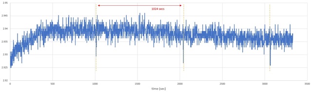

What makes nRF52832 chip voltage drop per 1024 secs ? softdevice or RTC ?
I've already asked this problem few days ago, but I couldn't figure out the clear answer.
The above figure shows the VDD values of BLE chip. The power supplied by coin cell and VDD values are
measured by SA-ADC in nRF52832 and sent to UART terminal.
Radio module wasn't operated.
The BLE chip was kept in room temperature (25 C)..
I know that the coin cell has high resistance and this could cause the those voltage drop
However, why this phenomenon occurred periodically??
What makes nRF chip voltage drop every 1024 seconds ??
softdeivce ? or RTC ?
