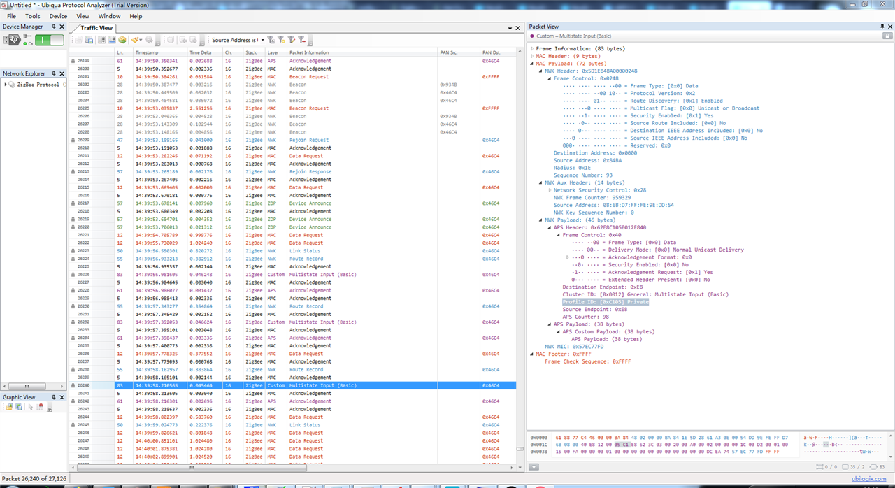

I have add a device A to zigbee coordinator, but the device A profile is private and data is not zcl, I can not get the APS data in application. How can I to get the APS data directly in application.

I have tried to bind this cluster to the device, but it no help.
I think maybe the question is from:
1. private profile 0xC105
2. NOT ZCL DATA
I have many other HA device(profile: 0x0104), like switch, 52840 coordinator can receive it's report attributes info.
only this device is different.
so, is there any different I need to do with this device?
Thanks!
regards,
By the way, I think the hard level has received the package, because it has replied device with ack in APS layer.

Can you please upload the sniffer trace from your screenshot? Or do another trace, if you have not stored it. Just save it as the default file type that WireShark use.
