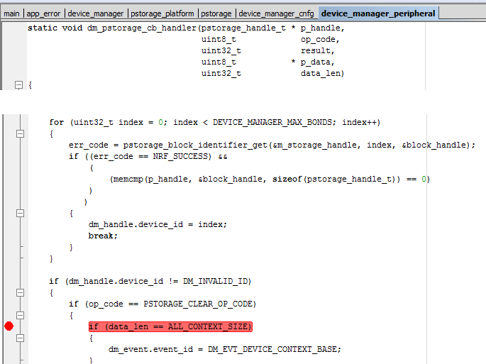

pstorage_clear or dm_device_delete_all is not working?
  • Custom Board with MCU NordicSemi nRF51822-QFAA
  • Softdevice S110 7.1
  • IAR for ARM 7.1
  • SDK 7.2 using a merged service (HID keyboard example + NUS example + HRS example)
  • Testing with iPhone 5S, 6 and iPad air (iOS 8.1.3)
/ Nexus 5 and Galaxy Note 3 (Android 4.4.2).
I added codes in device_manager_peripheral.c
void dm_ble_evt_handler(ble_evt_t * p_ble_evt){ //skipping to the changed part
   case BLE_GAP_EVT_AUTH_STATUS:
      if (p_ble_evt->evt.gap_evt.params.auth_status.auth_status != BLE_GAP_SEC_STATUS_SUCCESS){
            event_result = p_ble_evt->evt.gap_evt.params.auth_status.auth_status;
      else{
         if ((m_connection_table[index].state & STATE_LINK_ENCRYPTED) ==
                m_connection_table[index].state |= STATE_BONDED;
                if (m_connection_table[index].bonded_dev_id == DM_INVALID_ID)
                    //Assign a peer index as a new bond or update existing bonds.
                    err_code = device_instance_allocate((uint8_t *)&device_index,
                                                        &m_connection_table[index].peer_addr);
                    //Allocation successful.
                    if (err_code == NRF_SUCCESS)
                    else
                        event_result = err_code;
                        // my added part
                        if(err_code == DM_DEVICE_CONTEXT_FULL){
                            err_code = pstorage_clear(&m_storage_handle,
                                                      (ALL_CONTEXT_SIZE * DEVICE_MANAGER_MAX_BONDS));
                            //err_code = dm_device_delete_all(m_handle_pointer);
                            //m_handle_pointer is an extern variable pointing m_app_handle in main.c
The code's content is if the number of bonds reaches DEVICE_MANAGER_MAX_BONDS,
it will delete every bond infos.
Although the example code is implemented to erase all bonds when
BOND_DELETE_BUTTON_ID is pressed before initializing variables, I want to erase all bonds
automatically regardless of the button press.
I tried both pstorage_clear and dm_device_delete_all.
Even though both returned err_code 0 (NRF_SUCCESS),
it seems that the flash hasn't been cleared.
After the number of bonds reaches DEVICE_MANAGER_MAX_BONDS and calls these functions,
nothing happens.
Is there something that I'm missing?
Does these functions returning NRF_SUCCESS has relations with
DM_EVT_DEVICE_CONTEXT_DELETED (or other MACROS) or the scheduler?
Edited : About callback
I'm debugging with J-link.
image description
I set a break point here. After I call pstorage_clear, however, it doesn't
call dm_pstorage_cb_handler.
What could be the problem? Or did I misunderstand about "getting the callback from pstorage"?
-Regards, Mango922
  • Looks like it should work. What are you doing after you call pstorage_clear()? Do you give it time to actually clear the flash? Are you getting the callback from pstorage? See dm_pstorage_cb_handler(). You should get PSTORAGE_CLEAR_OP_CODE if the flashed is cleared.
  • I only added if statement and pstorage_clear function call. So after it reaches max, it calls the funtion
    and return NRF_SUCCESS. However, it falls into ble_error_assert. In short, I only added 2 or 3
    lines and it falls into the infinite loop. (I don't do something perticular after erasing the flash.)
    I didn't checked the dm_pstorage_cb_handler yet. I'll check whether I get callback.
    I haven't thought about time giving.
    Do I need a delay after erasing it? Is there time parameters for erasing the flash in the datasheet?
