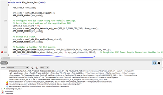

  • Yes I have followed the above steps but then we need to register the POF event with the softdevice stack that we can do by the following command
    NRF_SDH_SOC_OBSERVER(m_advertising_soc_obs, 1, sys_evt_dispatch, NULL);
    but I'm getting this error in this m_advertising_soc_obs variable. do you know about it?

  • 'm_advertising_soc_obs' undeclared (first use in this function); did you mean 'Advertising_Start'?
    This is the error that compiler shows and the screenshot of the code attached. also, there is a warning.
