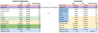

    Thank you for your response. By some fluke the controller worked after one flash but attempting to read system variables set on the device gave very strange data. This along with your mentioning of memory layouts prompted me to go looking how our apps layout  layout and what correct way to do its
    After a bit of digging and lots of testing I found that there was a whole chunk boot loader memory locations being overwritten by the application during run-time which is what was happening during the UART read. The app would try to read/write override bootloader memory locations causing weird unpredictable behaviour and mostly crashing. So I shifted all these variables down to stay clear of the bootloader and suddenly everything WORKS.
